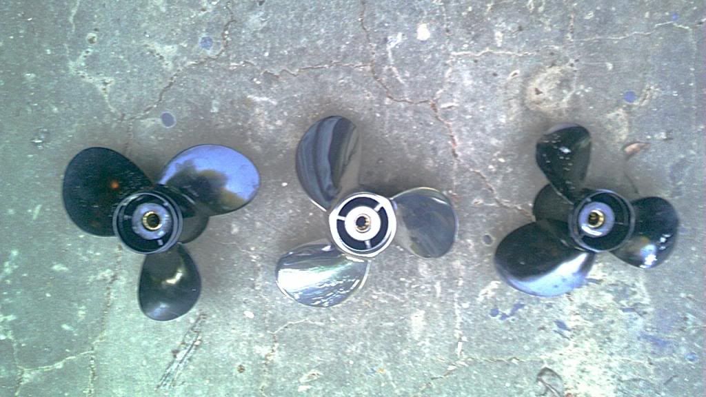

Sorry for the delay got the stainless prop last week and put it on only to realize my propshaft was bent. I ordered a new propshaft and it got here yesterday. I installed it this morning and ran out to Murvaul for a quick test. I can run 25.5 mph consistently and 25.8 mph on glassy smooth water. @ WOT I ranged from 5683-5727 RPMs so I really need the 10 pitch in this prop for Ideal performance. I'm happy enough with it as it is. Going fishing with a buddy next week so I'll see how it does with about 600lbs of persons and gear. As long as its above 5300 rpms WOT I wont complain.
MY three props.
Suzuki 10 pitch stock, Powertech SRT3 11 pitch, Busted Suzuki 12 pitch

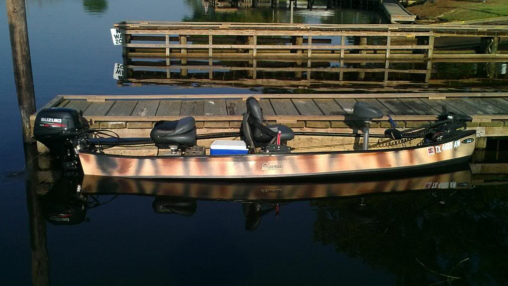

This is my rig.
Where did you get this Suzuki stock 12 pitch at?...to my knowledge they only made up to a 11 pitch,was that 12pitch a 9.25 in diameter?
