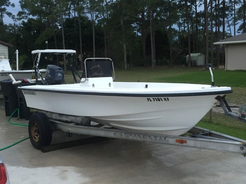

Picked this boat up in mid February, found on Craigslist in Merritt island. Boat was in okay shape when I saw her, and I knew with a bit of love I could have a nice skiff. I found out from the previous owner skiff holds a few IGFA fly records, for red grouper on fly. Anyways, got the boat home and started going to work.

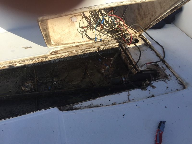

  • Pulled the main deck hatch and replaced fuel line from the pickup all the way through to the motor. New stainless fuel/water separator, inline fuel filter and bulb. Also resealed the sending unit while I was there. Note the rats nest of wiring, and had to do some bleach scrubbing as the underside was covered in grime.

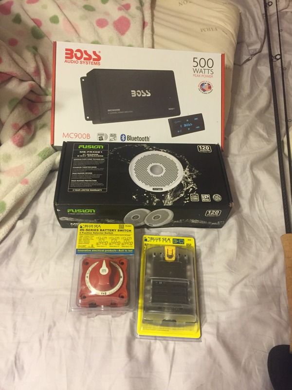

  • Re-wired the whole boat, heat shrink crimped connections throughout. Added a battery combiner switch.
  • New blue sea fuse panel, and rewired the existing blue sea circuit breaker switch panel.

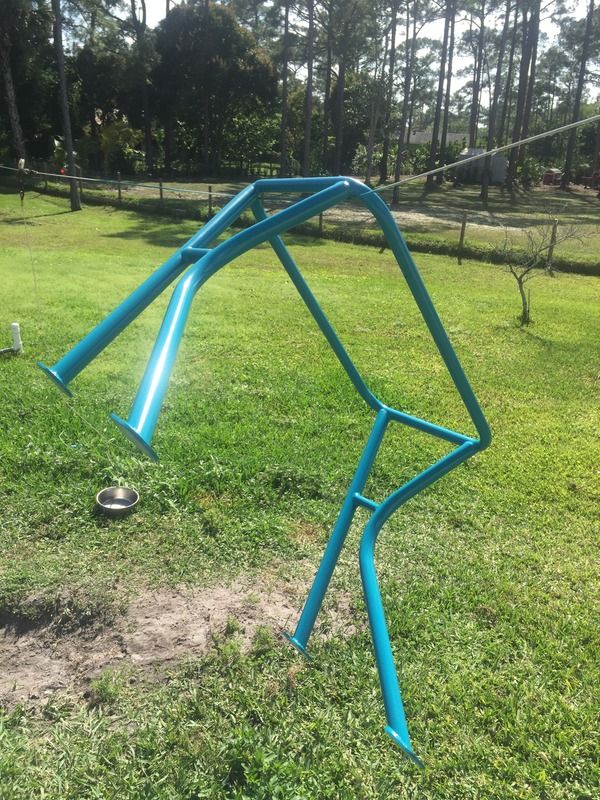

  • Refinished the poling platform as it was looking rough.

  • Added a Bluetooth connective amp so no headunit cluttering up the console exterior, along with two fusion marine speakers.

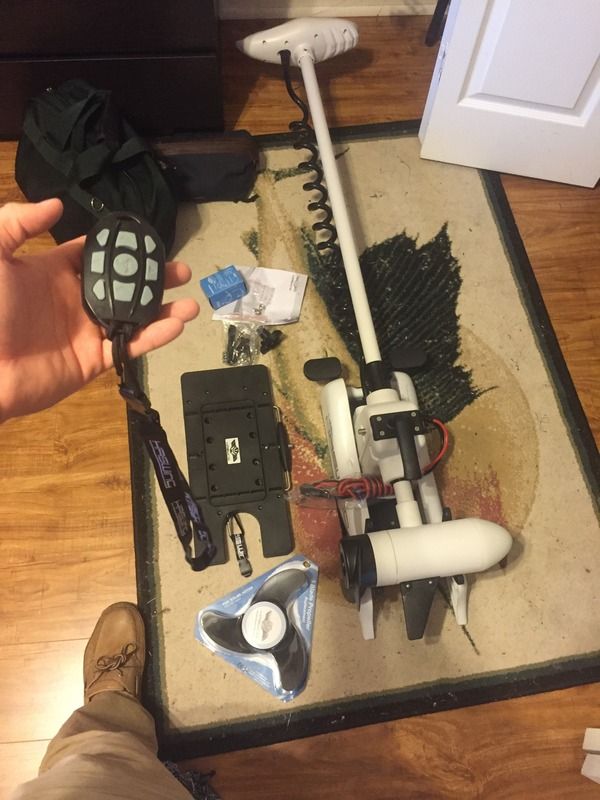

  • Bought a Haswing 55lb trolling motor and have been thoroughly impressed. Was sort of nervous about this as there wasn't much info out there on the brand, but after having been through some Minn Kota woes in the past figured it was time to give something else a try.

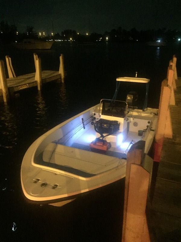

  • She has been coming along nicely, still a few more odds and ends to get to but for now she is fish able and everything works correctly.

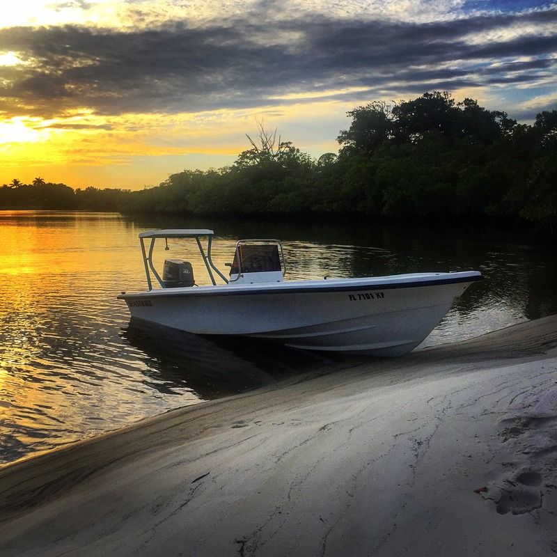

Have fished her for about a month now, and have really been impressed with how this boat runs in sloppy weather. This boat flat out eats chop. Deep vee hull is definitely not a super shallow boat and she is a bit tippy, but it rides so good in crappy weather I'm willing to give up the draft. I'm itching to get her over to choko, should be nice for long runs when the wind kicks up. Tab the bow down and let her eat.

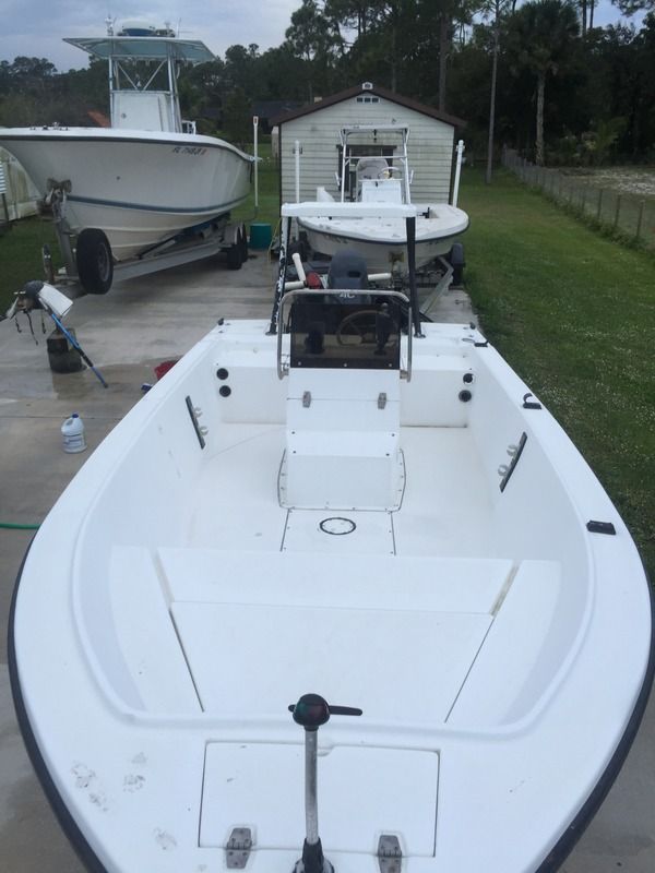

Thanks man, I'm really enjoying the boat so far. Just one boat. The boat on the left is my fathers and the boat behind mine is my grandfathers. Grandfather is working on his lift so it temporarily looks like a marina in the driveway.
