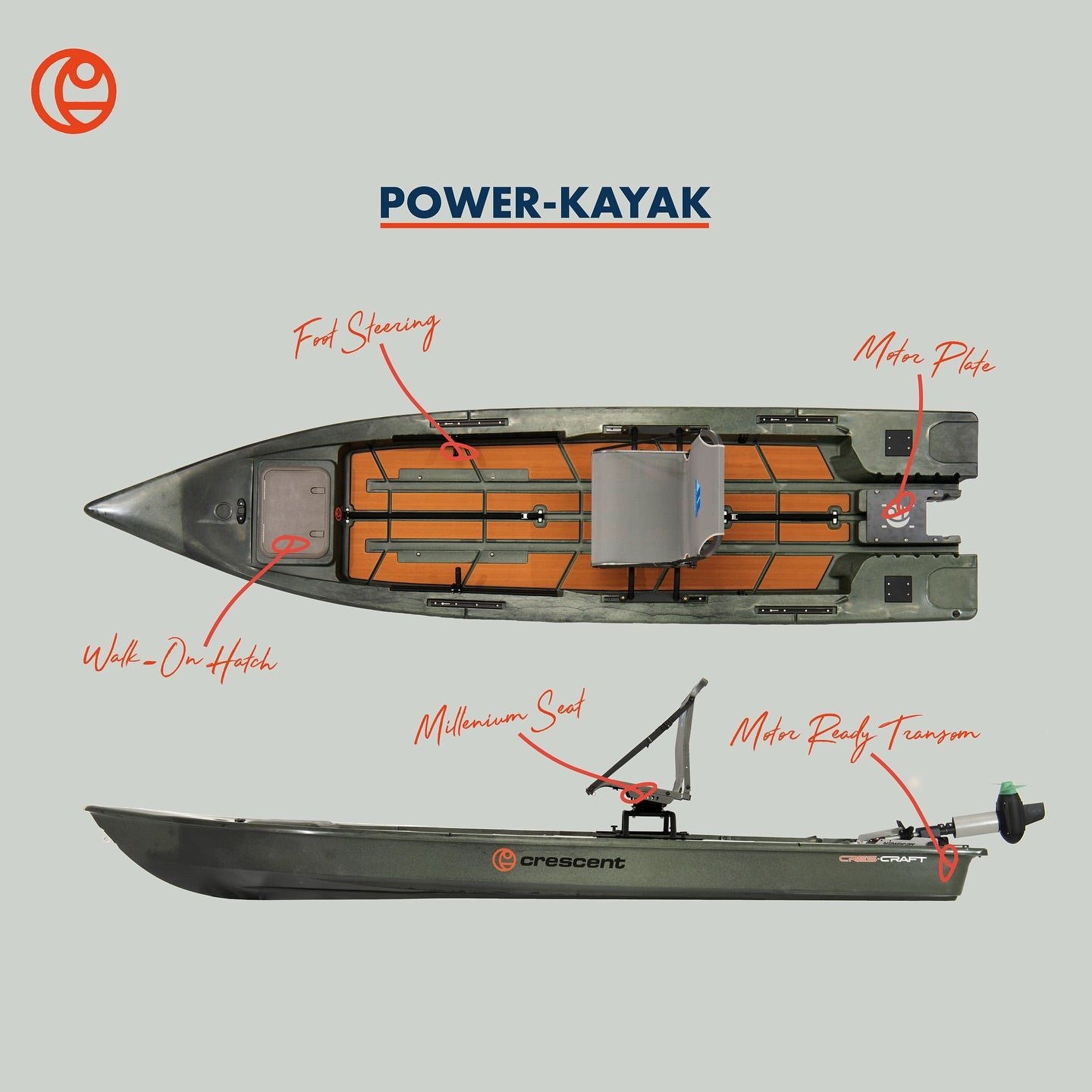

Thanks for all the replies. This is great information. I really like the L4, but I don't like that you have to buy so many accessories to get it to where you want it. The modular design is cool, but you have to buy so much along with the board.
I like building stuff and have an idea. Could be way way off, but love to hear feedback. What I'm thinking is something like the Jireh, Morejohn's stik skiff from 2018, drake outlaw, south dade, and this Crescent craft mixed. You can build all the skiffs smaller and they might work. Every boat that I'm on, I'd like to change in some what. So, what I'm thinking would be relatively easy to build over a month. If it was the "perfect" truck bed/camper shell skiff, am I missing anything?
-14' with sponsons to move the outboard up and weight closer to center.
-Flat bottom for rear 8' to fit flat on bed or on Thule rails.
-Under 100lbs. Probably the top weight for me and other people.
-I'm thinking of building two. One that is canoe like and super light and one has a deck and is self bailing.
-Rod tubes for two rods.
-Handles for carrying.
-Ability to mount trolling motor and battery.
-Graphite power bottom to drag over "stuff"
-48" beam at the deck with a slight chine for roll.
-Ability to mount a 9.9hp or 15hp 2 stroke. This would require stern flotation and a beefy transom. Not hard to do at all.
-V entry for chop.
-Spray rail or flair for waves.
-Rounded transom.
-Double cored transom.
