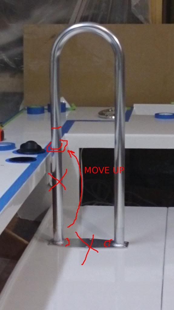

I recently bought a Fishmaster grab bar. It's an ok peice of gear....but I want to modify it. I want to turn it into a side mount rail much like the old ECC gladesmen rails

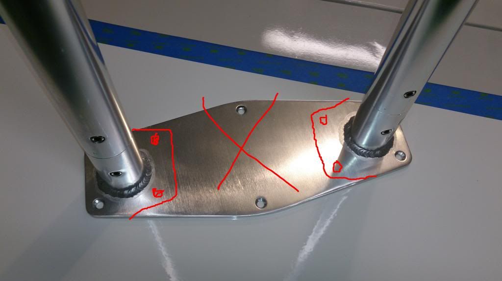

The thing that makes this all possible without welding is the fact that these things have a removable base attached with a friction plate detent/ detent screw mechanism. So, what I want to do is to cut the base plate in two and tap new screw holes, trim one side of the grab bar tub and drill a new dent screw hole. Take a look at the pictures below:

abrasive will load up w/material...........sawzall w/ metal blade,sabre saw etc will work fine...use "blue sand paper to smooth out edges

I had that grab bar on my Gheenoe. I'd be aware of cutting that base. If you cut the port side as shown in pics, you will need to reset/thread the screw into the new aluminum. Also note that it will flex a lot more when the base is apart. I'd find a local welder and have him weld on a round pad to the base of each, and a cross bar for additional support from flexing... It's a great tool for what it is, on e modified it can get sketchy, if not done properly.. :cool:

... If you cut the port side as shown in pics, you will need to reset/thread the screw into the new aluminum....
Sure thing! That's what I was referring to when I wrote, "drill a new dent screw hole" in the original post. I think it will work. I just need to build up the courage to cut aluminum for the first time. Heck...It's no different than when I first decided to build up the courage to cut wood. A freaking flats boat came of that! lol
Thanks for the heads-up all Very kind of you all to reply!
Oh oh.....yeah, a new cross member is NOT a bad idea but than means I would have to involve someone else. I don't have welding tools.

Seriously though, aluminum is soft! It is easy to cut, drill, shape, etc.  Just Do It!
And look at anytide's "stuff box" it will tie the grab rail together pretty well.
