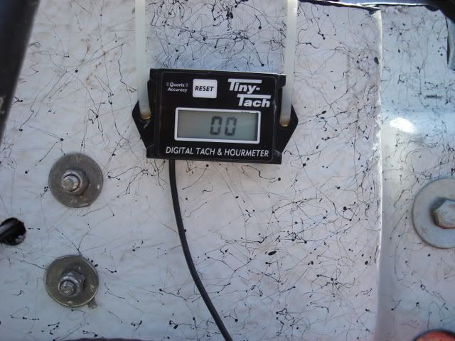

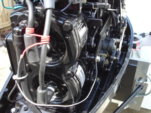

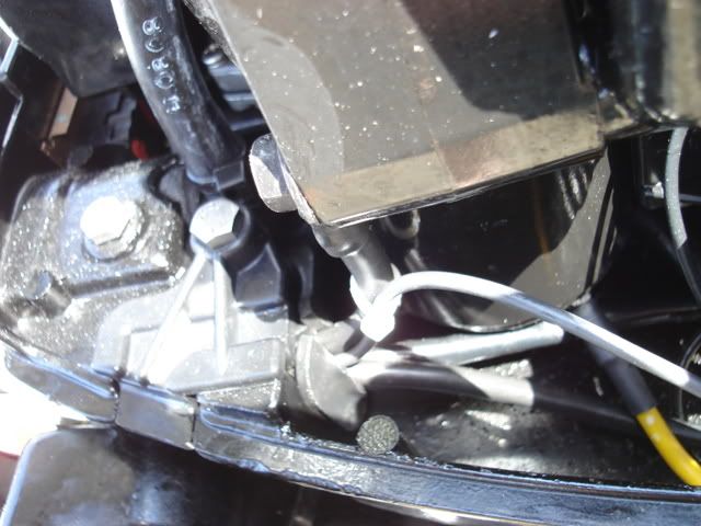

Well I had some time last weekend and wanted to add this to the LT-25. Never used one and was suprised when I opened the package and read how easy it is to install. Red wire wraps around both plug wires (just wraps no cuting) the white slips under any bolt that is near.
I ran the wires thur the rubber plug that the batery wire was in and that was it all done. a few (ok more then a few) zip ties and all was clean and tight.

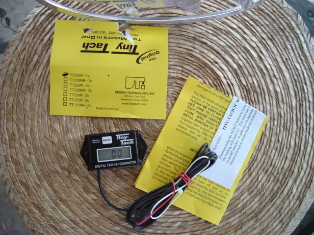

Well I got the replacement Tack in the mail with alot of help from Capt Ron. He called the factory and educated the maker on what would work the best on a 25 Merc 2-smoke. The factory mailed me the 2XL and I put it on today. Have not had the time to run to motor other then in the back yard with the hose on. The first tack they sent was running at apox 2070 rpms and we all know that was wrong. The replacement model (2XL) ran on the hose at 370 to 420 rps. Can't wait to run it at wot and see where I am at with the stock prop.
Thank you Tiny Tack for the replacement model.
Thank you Capt Ron for catching the mistake even before the open water test and jumping in and fixing it without being asked!
#6 ·
Hey MAT,
That sounds too low, your RPM should be about 750-800... Might want to double your set up.
Cheers
Jan
What Jan said.
Pretty sure it's 4 wraps on the lower plug wire.
What he said!
Why does my 1-c tach read 1/2 time on a 2 cylinder engine? You need to attach the wires to BOTH cylinders. Make sure you use only 3 wraps with the wire.
Cheers
Jan
#7 ·
Hey MAT,
Cheers
Jan
What Jan said.
What he said!
Cheers
Jan
2XL is a different Tach specifically for Mercs and installation is different. If you run a longer leads, you may have to make additional wraps to overcome the resistance. While Tiny Tach's are a great tool, IMHO they are far from a perfect science. I have some different models ordered that I'm going to test also.
#13 ·
I dont know about which leads you guys to need to wrap for your black anchors, but use 4 wraps rather than three to make sure you are inducing enough current. Supposedly the resistance has been calculated by the manufacturer and that is why they say to not alter the lengths. Of course there is that small percentage that falls outside the norm which will give you a bad reading in terms of off by several rpms, but yours sounds more installation error.
#14 ·
"Black Anchors" as you refer to, are a little different. Yes the resistance is calculated in and when you go to a longer harness sometimes you have to do an additional wrap to overcome the additional resistance from the additional wire.
Matt - 4 wraps - one plug wire and I think you need to use the lower cylinder for some reason. I'll try to do mine this weekend and let you know. ;)
RJ, you have a 1C and it's a different animule as well as your running a 3 cyl and not 2. ;)
