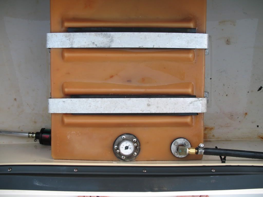

Getting around (finally) to installing the trolling motor on the bow of the pathfinder tunnel hull, and might like to put the batteries and charger in the bow storage area near the fuel tank.
Tank is poly, below-decks but remote fill and vented to the outside. The compartment it's in naturally is not vented to the outside and once the hatch is closed, would be a somewhat sealed compartment.
I will be using Odyssey batteries for no leaks/gasses.
Should this be a concern or not?

Had the exact same tank in my old "T"... Personally I wouldn't do it. The poly tank let vapors out and my front hatch reeked of fuel if the hatch was left closed over time.

I don't care what style tank you have, batteries and fuel tanks in the same compartment scare me.
Why? I've seen fuel lines split, clamps snap, tanks corrode and leak, fuel fittings fail.
Combine gasoline fumes in an enclosed compartment with an electrical spark, can you say "Fuel-air bomb?!!!!!"

There was a rigging tube under the gunnel from stern to bow to bring power to a pop up bow light. I used that channel.
