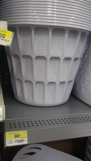

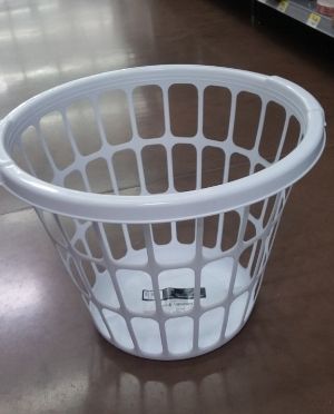

Go to your local Walmart. Go to the "HOME" section where they have clothes hampers. Buy the cheap 98 cent white hamper shown below.

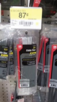

Then go to the "TOOL" section and buy a 87 cent pak of 8-9" long white zip ties.

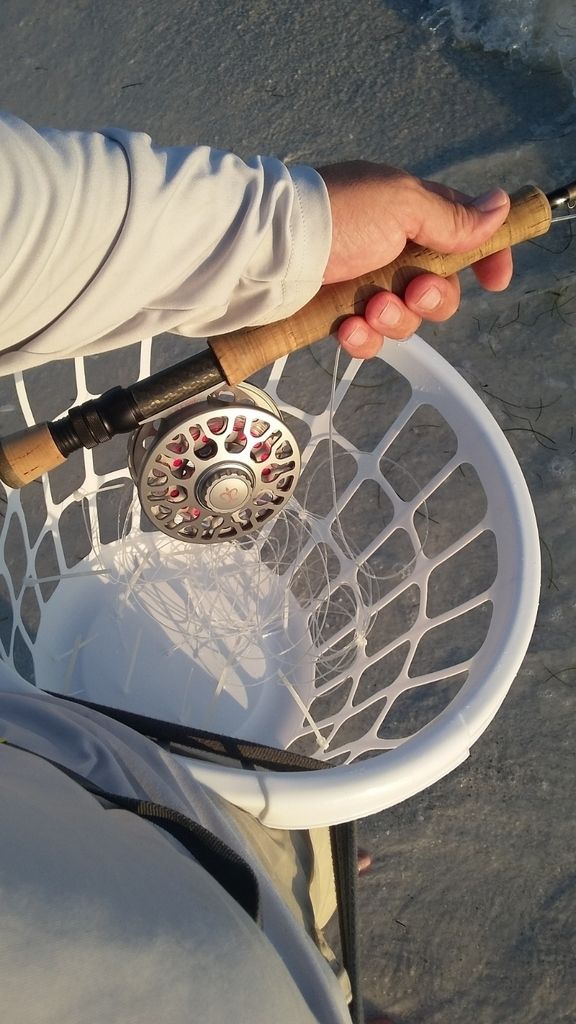

Zip tie the zip ties on the sides of the 1st rail that runs around the basket, pointing inward at a 45 degree angle, pointing inward and upward (notice the finish basket). Space them around the ring ever 4-6" or so +/-. Next take a sharp knife and poke small slits up thru the bottom of the basket, just big enough to tightly but firmly push the zip ties up thru the bottom and space them evenly around the bottom of the basket. Make sure you pull the zip tie firmly up till the little square thing stops it. There is no reason to cut 2 slits and zip tie them back thru the square locking mechanism. You should be able to use up the rest of the zip ties doing this. I then cut all the zip ties down to 6" each, but you can leave them long if you like.
Take an old belt and put it thru one opening near the top rim of the basket and go over several openings and then put the belt end back thru that hole. Wrap and buckle it around your lower waste and buckle it loose, so it can be adjusted. I like it to my stripping side, on the side of my leg where the top is about where my side pocket opening ends and the bottom of the basket where my knee is. Then I adjust it slightly angled towards the front of me and the opening rotated downward about 30 degrees so my stripping hand can throw the line in without touching anything.
The end result is that it weighs nothing, costs hardly nothing ($2) and I can strip line in like it's not even there and it holds the line in almost better than any stripping basket I've owned. It also keeps the line from tangling. Especially with intermediate lines, you shouldn't beach fish without a stripping basket of some kind due to the sand getting on and sticking to your fly line, coupled with the breaking surf on the sand and your line in the surf breaking on the sand is like dropping your line into the clothes washing machine and tangling it all up.

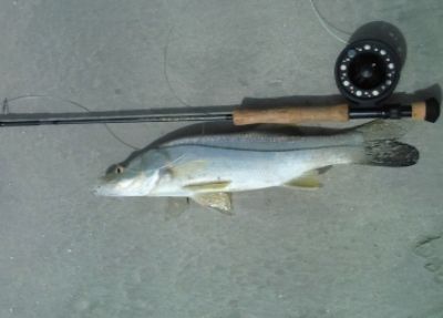

2. What year (approx.) and model is that 3-Tand, it looks slightly more grey/matte than the one I have? Could just be the lighting...

It's last year's model. It's pretty much been fished hard and beat hard. I'm trying to use and abuse this one to see what she can take and it keeps on ticking and clicking off the fish numbers without a hitch!
Back on topic, every fly fisherman I've seen on the beaches lately are not using a striping basket at all and every one of them ran up to me and wanted to "Ooo and Awe" the basket, not the snook I've been catching! Ha! So far, I've gotten "thumbs up" from all of them and I've left my other stripping baskets at home. Lol You might think it looks lame and goofy, but I'm having fun with it and the way I keep it position, it doesn't even feel like I have one on me as my hand is throwing the line in the direction as if there were no basket and just throwing it on the ground. The wide mouth tilted forward keeps my stripping hand from touching nothing and the angled zip ties catches everything I throw into the basket without letting it fall on the ground. I also notice that I can walk around without flyline falling out of the basket, like some baskets allow.
