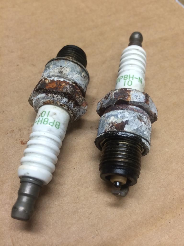

Runs reasonably well. There are some idle issues that I've been trying to work on. I have replaced the spark plugs a couple of times now. After maybe 6-8 trips they look like this. When I change them the motor runs much better. I've never seen an outboard do this before. Any ideas? I am using the plug that is recommended for the motor. Almost like they are running too hot?
These plugs were new a month ago:

Looks like the plug if firing fine but you are getting water under the cowl- either from spray or when washing.
Clean everything and spray it with a corrosion inhibitor.

Everything duckNut said plus look for a stainless steel equivalent plug

Also check for a gasket leak/bleed dripping from top to bottom.
I've had that happen between the water cover and cylinder head.
Salt deposits will lead to the source.
