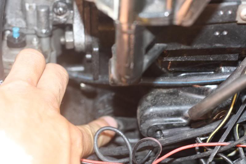

step 2: take cowling off and put motor in FORWARD gear
step 3: while shifting motor in gear, look on the port side of engine (if attached to boat) behind where a starter should be, locate the clip that attaches the gear shift.
step 4: with a flathead screwdriver, GENTLY pry upwards the pin, once it slides up, it will be loose and you can slide it out.
with this out, it is now time to work on the lower unit.
