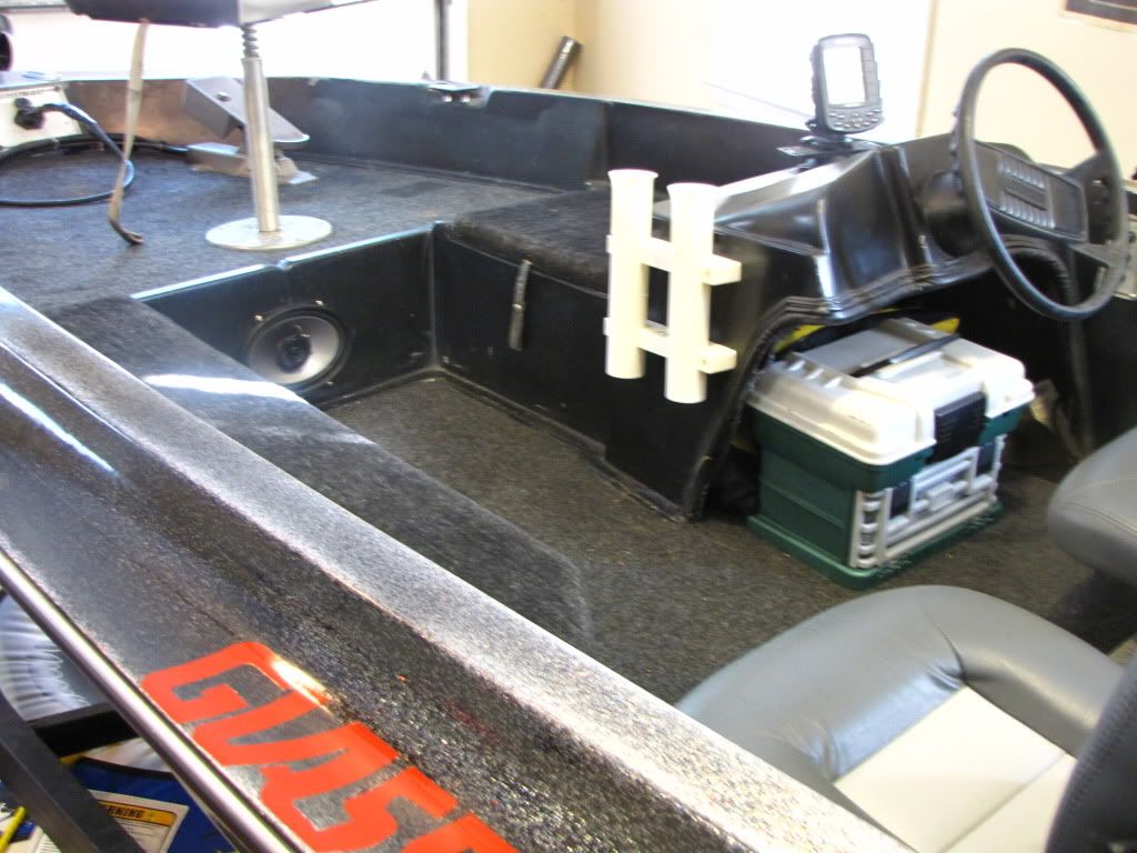

Hi I've been sanding inside my boat, taking off a spray paint layer that a previous owner put on it, for about an hour now. This is my first time using a power sander and not sure if I'm even doing it right. Do I just do small circles or long strides back and forth or just hover over a spot? Also I'm not sure what wet sanding does but maybe I need to do that? My progress so far is maybe 1 square foot total area of corners that have been sanded because the paint was thin there.

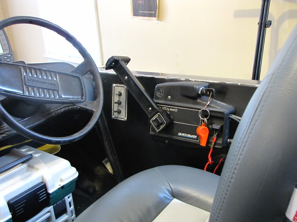

Not really sure what you're trying to show in the pictures, but what kind of sander are you using? 1/4 sheet? random orbit? air powered orbital?
What grit paper are you using? Start with a rough grit like 60 but stop sanding with the 60 when you get through the paint most of the way, then step it up to a smoother grit like 100. I perfer to sand with 150 grit before priming and 220-320 between coats of paint. Aways keep the sander moving so it doesn't dig in to bad. Small circles or a zig-zag pattern work well for me depending on what I'm sanding.
The pictures is just showing what I was going to be sanding I guess because a lot of people don't have spray paint inside there boat I don't think. And thanks!! I will definately do that I need to buy some 60 then I'll resume to my 200. I have 5" orbitals and some smaller triangles for the detailed spots. So I have an orbital sander and the detailed sander I guess is a random orbital? It just vibrates or shakes a bit. Sorry for my ignorance I guess you could call me a youngster without my dad to help me so I'm completely relying on you guys.
