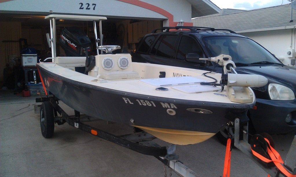

I have a 14' Piranha with a Merc 50 ELPTO and a Trophy Sport 10.625 x 13p.
It revs just over 5000 maybe 5100. WOT should be 5000-5500
It gets out of the hole pretty fast and gets up to full power fast also. top end right now is about 34mph. Seem like I should be getting 40 +. Maybe I should be running a 3 blade?
The hull weighs 420lbs, the engine 204lbs, two batt 100lbs, trolling motor 40lbs, CC steering cables hardware maybe another 100lbs, 12 gallons 70lbs, fishing gear with ice etc 40lbs and my wife and I 300lbs for a rough total of
1274lbs
Oh and at its widest spot its 72" here is a pic.
Thanks in advance
Glenn
