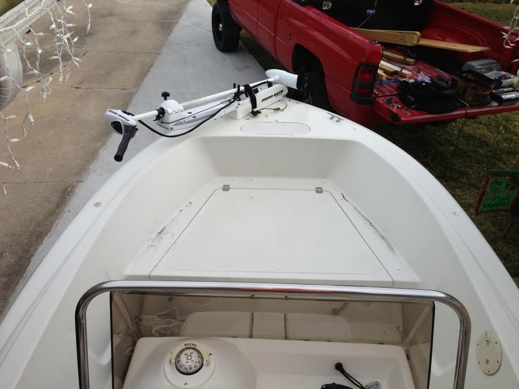

Looking for some help on how to fill/patch some 1/4" holes on my parents old boat. I removed the side rails and am remounting the trolling motor. So in order for the boat to look its best I need to fix these holes.
Any help, links to a kit or how to would be greatly appreciated!!!!
