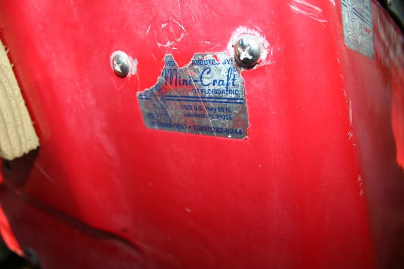

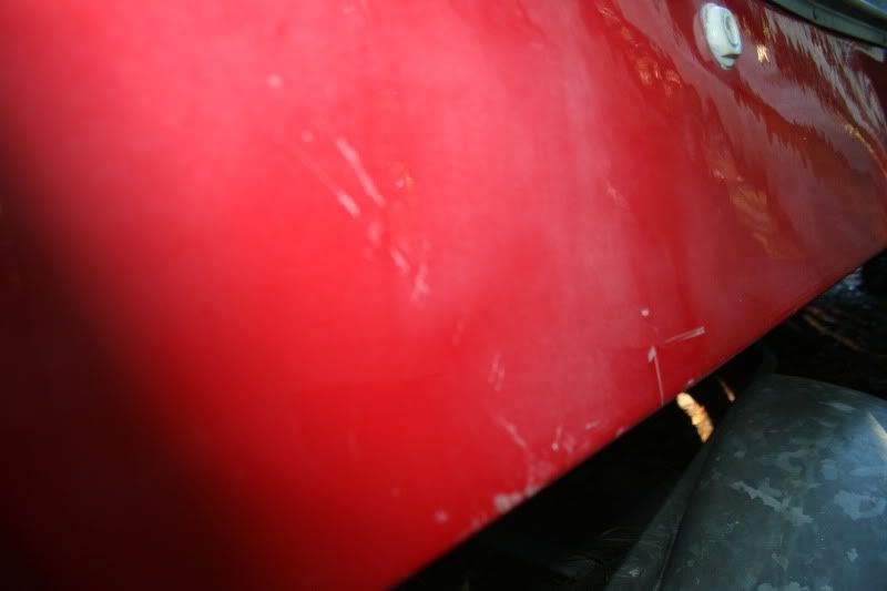

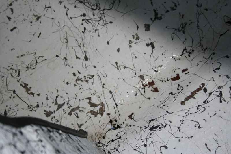

Hey all, I have a fiberglass gheenoe classic and I'm looking at repainting it the same color (red). I want the paint to be glossy as it is right now- if you can tell by the picture. Im not sure if its a special coat thats put over the paint, or the actual paint itself. Any suggestions would be great. Also, the interior has some rough spots as shown in the picture. From your knowledge, what would be the best way of going to repaint over this. So basically Im just wondering what I need to get and where to get it...and the best way to save money :) Thankyou

Surface preparation is going to be the hard part.
Filling the dings and scratches, sanding, priming,
sanding, priming and then finish coats.
The gent you need to be talking to is forum member str8outha9c.
He knows a heck of a lot more about it than me.
Riptide Boat Works N.C.
173 Posts
One of the best is awlgrip, you will need to sand the hull with 120 grit paper , fix all your danmaged areas , then 3 to 4 coats of 545 primer ,a qt of base and a qt of converter and some reducer should be plenty , follow instructions for recoat times, wait a day, sand all the primer with 320 grit paper , wash the dust off the boat and your ready for topcoat , 1 qt of converter ,1 qt of paint and reducer again is all you should need , follow the instructions , there is enoughf paint to paint your boat twice if you mess up the first time , take your time between coats , and spray a test pannel to get your gun right before you start on the boat . this is a crash course on painting but would be glad to help in more detail if tinterested
