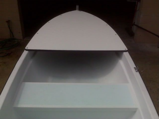

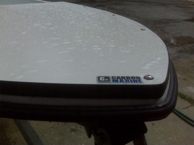

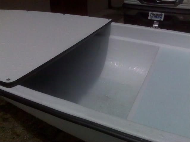

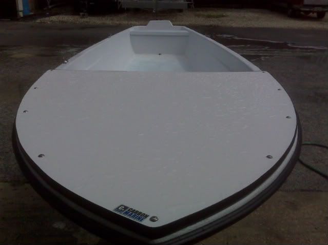

This boat belongs to Onthespot.  Here are the first photos of the new decked ECC NMZ Glademan.  Also, the first photos of an all carbon fiber aftermarket bolt on deck (carbon and core foam construction).  Dimensions are 57 inches long by 46 inches wide tapering down to follow the bow lines: 13lbs installed.   The deck is removable.  The entire surface is treated with anti-slip. The opening is sized for a drop in cooler or leg room while sitting.
Makes a nice no motor zone rig.
