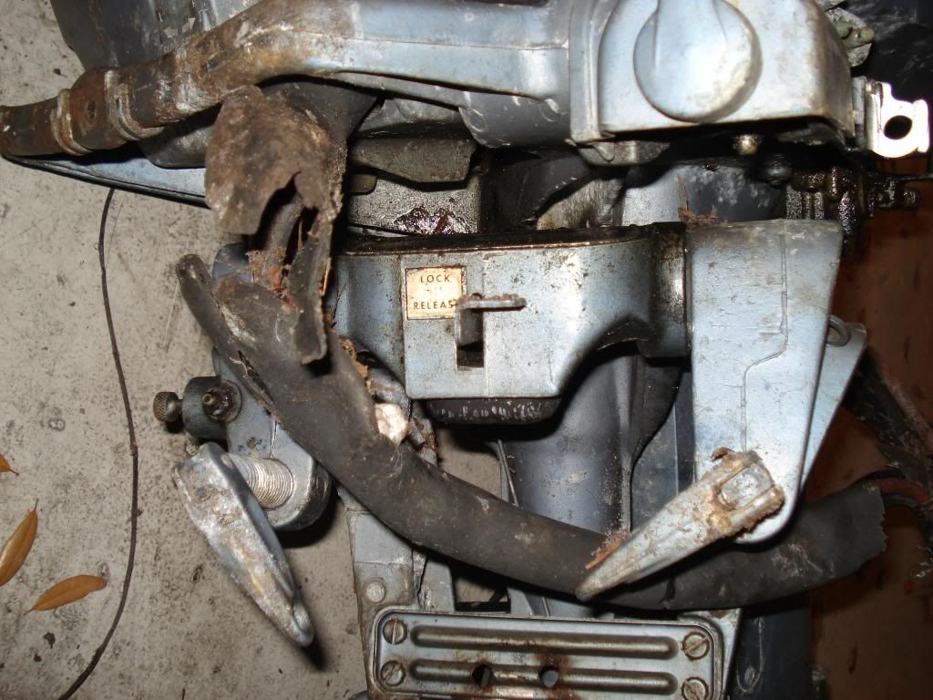

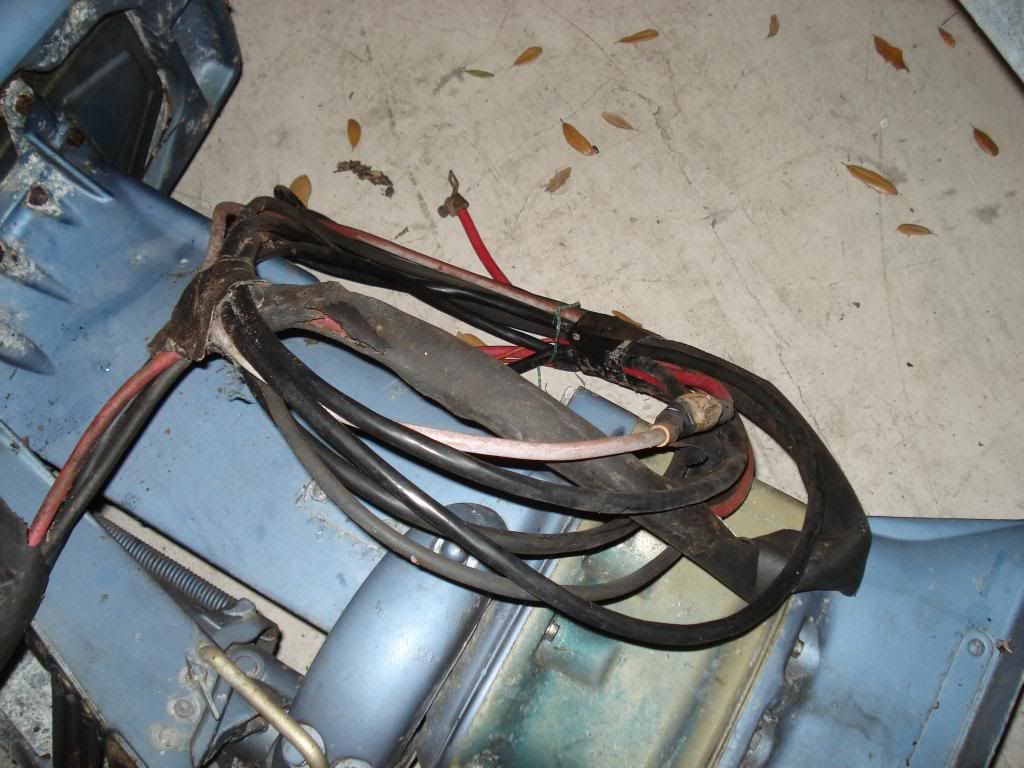

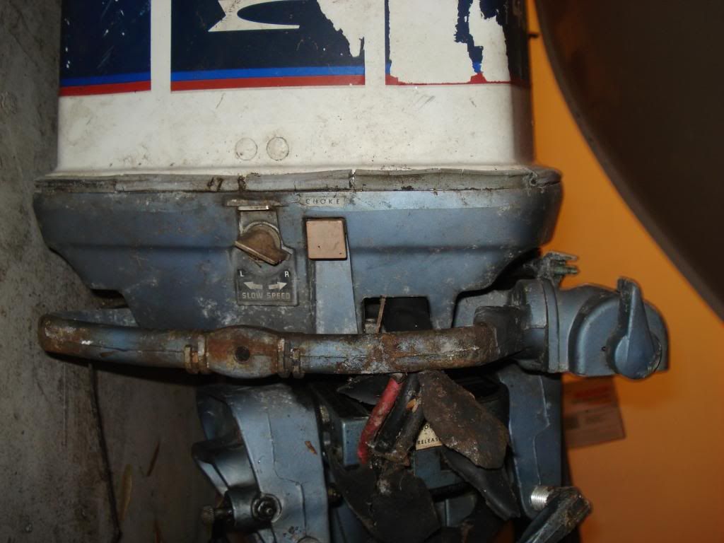

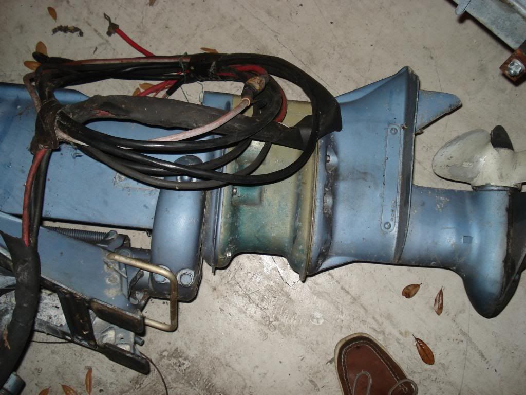

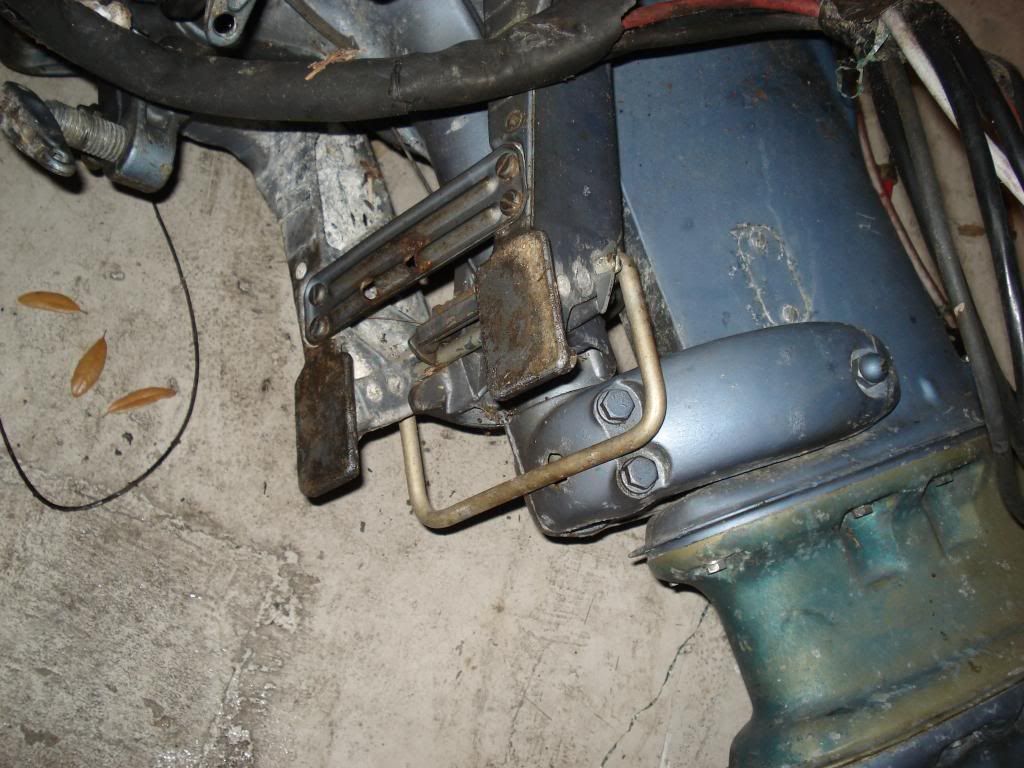

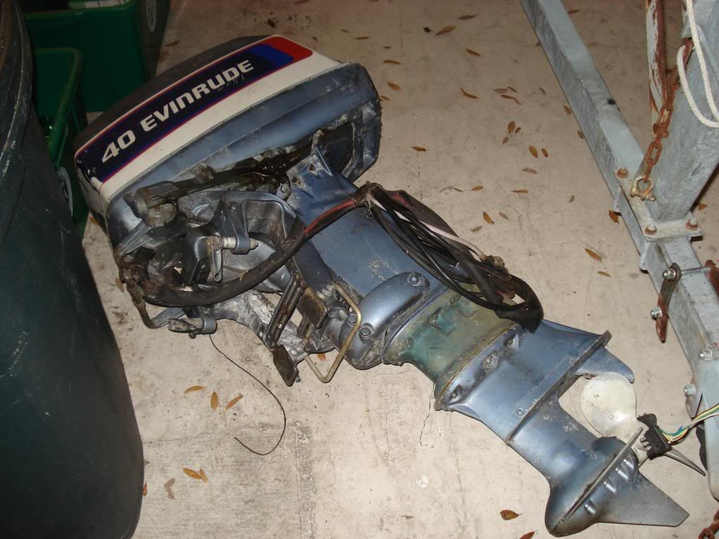

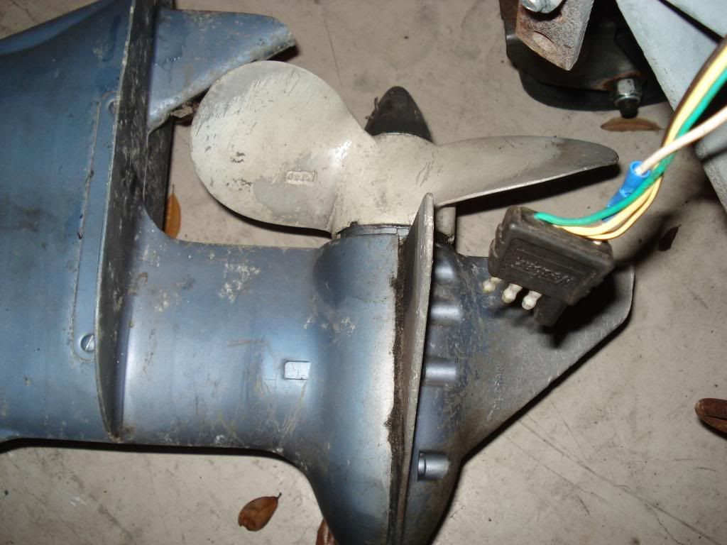

Just picked this up for free. Sitting in a yard for God knows how long. Luckily...it was covered up. The guy just wanted it gone. It will be for a J16 15" transom. Should I keep it or sell it? It looks like it has some sort of shaft extension on it that I would have removed. I can't do any of the work myself so I would have to pay to have it done. Don't know if it runs or not or what it needs. I also want to get a tiller kit for it...is that possible/cost efficient? I'll remove the cowl tonight and see what it looks like underneath. It really is cleaner than it looks...just needs to be hosed off. Here's pics

Looks kinda rough,I don't think I'd spend too much on it trying to get it running. These motors aren't bad, but they are loud and rough.
You might be better off cleaning it up and selling on Ebay for whatever it'll bring. Maybe even part it out. Definitely clean her up good first, someone out there needs some parts off of it.
On the other hand, if you clean it up, put some fresh gas/oil in it and it cranks and runs, hang it on the back and run it. The price is right!

Without more info, I'd guess that to be an early '70's commercial 40 hp.
The 2 part lower unit is what indicates the commercial usage.
Was easier to service on a regular basis without special pullers.
Electric start remote setup from the factory. Standard engine was 15"
shaft, to get the 20" shaft an extension and longer driveshaft was needed.
To remove the extension, you'll have to find a 15" drive shaft.
Good luck doing that with such an old motor. Seeing the corrosion on
the bolt heads tells me trying to disassemble is going to be a major
job. Sitting as long as it has, I bet the pistons and rings are one with
the engine block.

Not sure exactly how long it has been sitting...previous owner confirmed that his father had it on a boat not horribly long ago. I would guess it hasn't been sitting more than 5-10 years. Can the electric start be by-passed for pull? I guess I would have to modify the cowl...
Corrosion isn't bad at all...looks worse in the picture. I'll look at it further when I get home...at the library studying right now. How can I tell what's going on with the pistons and rings? I guess I'll be able to tell more when I take the cowl off...
I'll post more pictures later tonight or tomorrow.

Converting to tiller would be difficult, not impossible.
Finding a pull start cowl and assembly will also be
problematic, due to age.
To see if the engine has seized, try to turn the flywheel.

If the engine was extended to 20" using a kit, it may have a removable driveshaft extention and water tube extention. In that case all you have to do is take those off and bolt the lower back on... might as well change the impeller while your in there.
As far as the tiller, I can see the throttle shaft in the pics and there seems to be some kind of knob(?) where the tiller would bolt on. Try taking that off and see if there's a brass gear under there, if so any older johnnyrude tiller will bolt right up. It would take one of the clamshell tillers used by OMC from the 50s all the way up to the mid 80s, when the switched from shaft driven to cable type throttles.
Keep in mind this engine will never perform like a modern 40. In my opinion the older OMC lower units with pin type props always held these motors back. There is virtually no prop selection and the props used are small for the power. It probably won't be fuel efficient or fast, but with basic maintainance, the older motors can prove to be some of the most reliable. ;)
