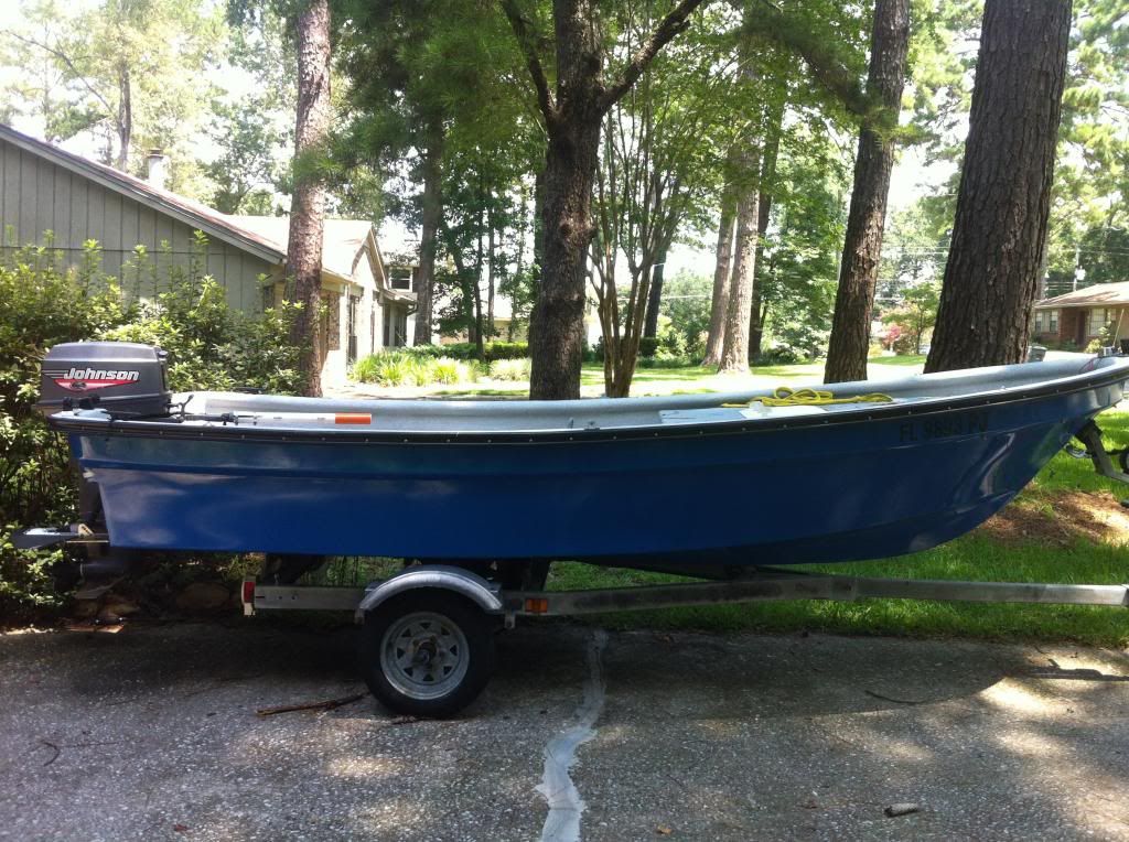

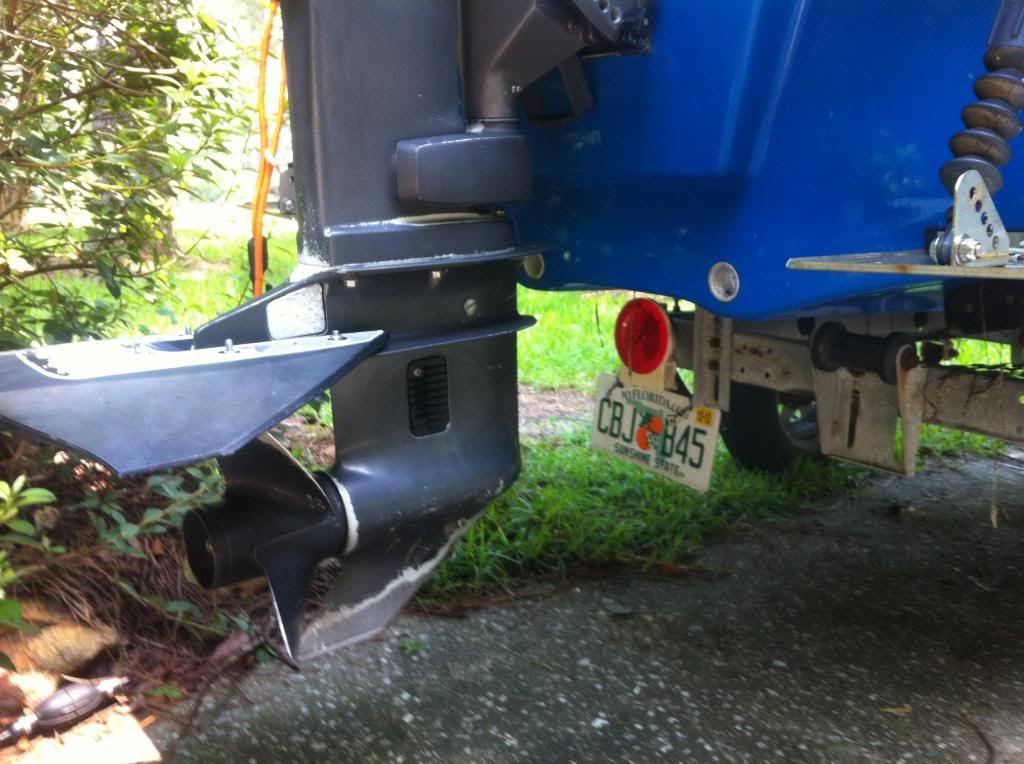

    So here's my boat, Runs fine aside from the fact if im sitting and running I cant see over the bow.... yes i'm short. the bow rides high as you can tell from the curve of the boat. Draft with motor up is about 5" loaded for fishing. with motor down I need near 18" to run. I think my motor is sitting very low.... I am in the process of making a manual jack plate. If this were a standard v hull id know where to start since it not I am at a loss for high I should start. it the anti cav plate 1" above bottom rule still apply?
    I dont want to go to high as this boat currently handles nasty weather like a champ... your thoughts? new prop will be coming soon so I can change that as well.

    Welcome, that is a pretty neat skiff there. What kind is it?
    From the pictures it is always hard to tell, but I'd say it is a little low, but not too much. Another inch or so wouldn't hurt. It won't help the lack of vision issue, does the bow run really high when you are on plane? Maybe better weight distribution or motor trim, would help it run shallower as well.

    cavitation plate(w/ hydrofoil) should be at least even w/bottom of hull or 1-2" above

    Right now cav plate is about 2" below, so 3" would be a big difference in running depth.

    1" above bottom of boat will probably do it for u>normally u start out w/ it even to the bottom sor so they say

    Where did you get that stubby panga?
    Nice boat! Be sure to post that jackplate build.

    So is it a panga 14? from which company?

    looks like Panga marine, boat is an 04

    Motor is definitely low, like other have said raise it up at least 1" above the bottom of the boat.

    Ah but it would be worth the reduced draft. After getting the level out and doing some measuring at the moment I am going to raise the motor at least 4" to put me at the 1" above mark...I am preety sure my current prop is shot so a new prop will be on it's way when I figure out what to get.
