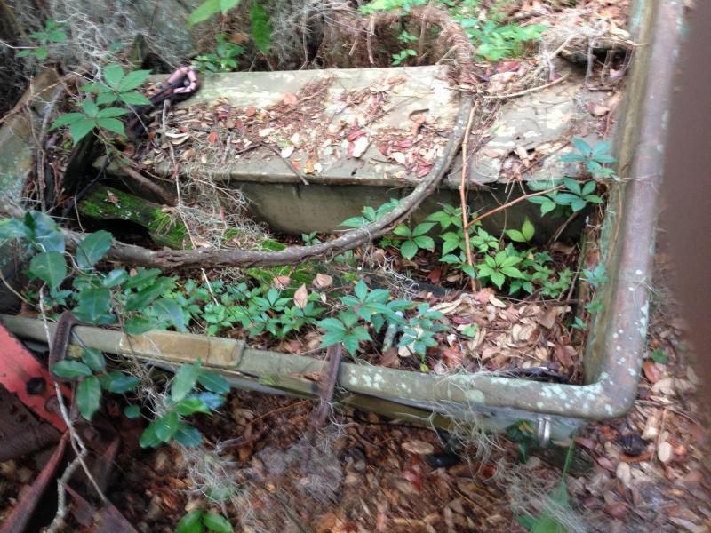

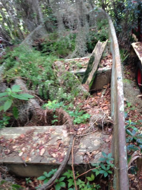

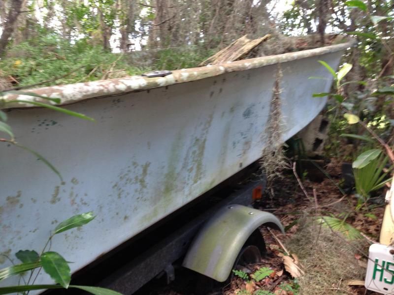

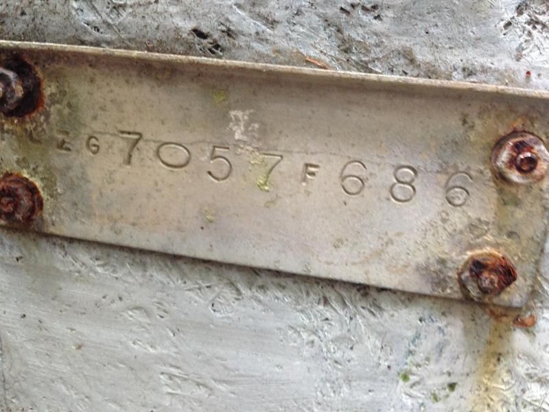

I found my grandfather's old skiff (possibly Johnsen?) in the trees, in the back yard of my grand parents house after they passed away a few years ago.  It has been there at least 25 years, and has trees growing around it, 2 feet of leaves, dirt, & plants growing in it.  The outside looks solid, with no holes in the bottom or sides of the hull.  The inside benches are starting to delaminate.  When I push down hard on the rolled edge of the side, I hear slight cracking sounds.  Can I just clean it out, put a couple of layers of glass on the inside and call it a day, or is it too far gone?

Thats really cool. Bare fiberglass can deteriorate when left in the sun for very long amounts of time. Your best bet would be to clean it out, find the worst looking spot, give it a quick sanding, wipe it down and put a layer or two of new glass in the area. Let it cure fully then give it a whack with a rubber mallet. If it delaminates or cracks then its too far gone, if not, well then its time to start a thread in the bragging section

I would be all about restoring it, especially for sentimental reasons. BUT, fiberglass can Deteriorate beyond repair, and needs to be "checked" by how I described. Fiberglass may last for almost ever but the resin in the laminates gets broken down by UV when there is no more protective layer (gelcoat or paint)

Thanks for all of the replies. Great suggestions. I need to see if I can hunt down the title before I start chopping trees down to get it out. If I have any luck on the title, I'll drag her out, clean it up, then go from there.

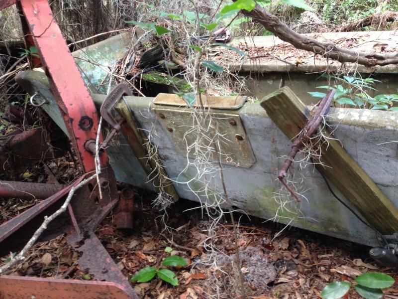

The wood pieces that are clamped the the transom are used for the transducer to the fish finder. He didn't want to drill a hole in the transom, so he mounted the transducer to the wood piece, then clamped that to the transom.

I would flip it over and see if the hull has warped around the bunks from the weight of water / debris resting in the hull over the years. If it doesn't show any warp I would take a sanding wheel to it and fix it up. Shouldn't be too expensive to bring back, just elbow grease and time. Getting a functional motor and trailer will be thr big cost. As mentioned figure out the title before you invest money into fixing it.
