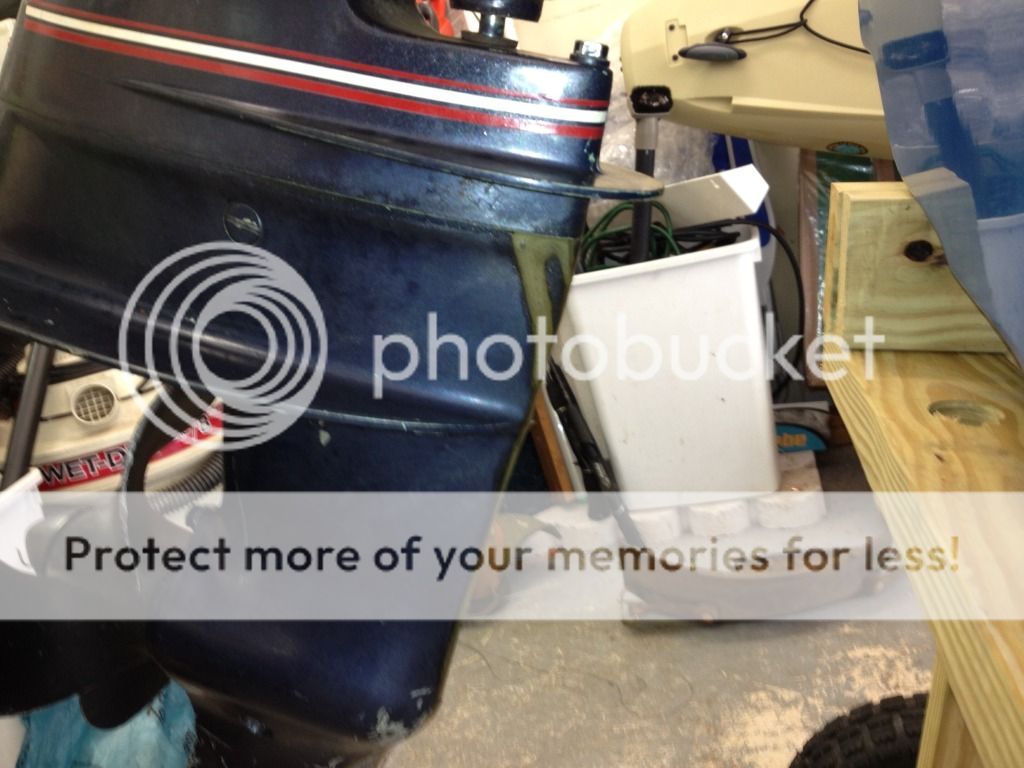

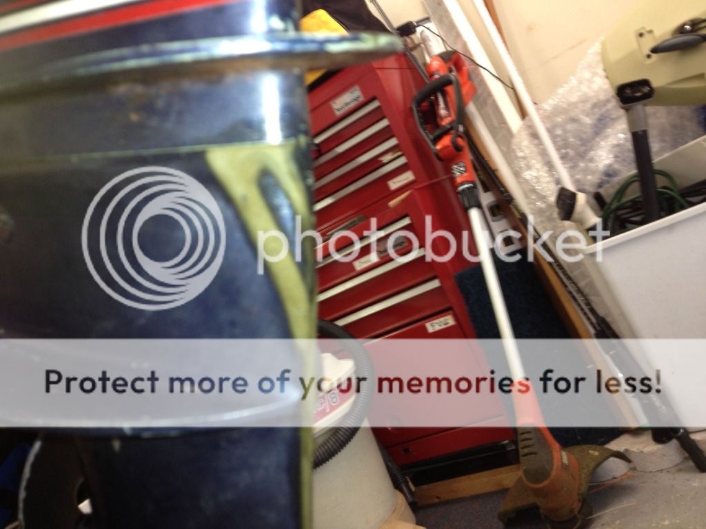

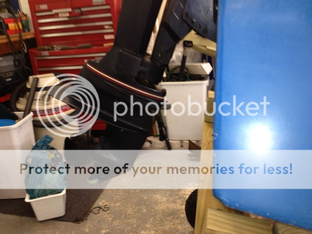

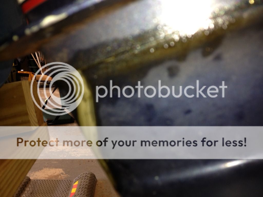

I'm new to boating and just bought a 13 foot gheenoe with a 4hp deluxe evinrude.  I believe it is an 89 model. I just got back from a trip yesterday in salt water and flushed the engine with freshwater in a bucket.
I had no problems with the engine when i was out on the water.   This morning I noticed it was leaking oil from the lower unit.  Can anyone tell me what is going on here and what I need to do?
Thanks in advance,
J.T.

Unburned 2 stroke mix...it coats the inside of the exhaust housing
then leaks down overnight to produce a gooey mess for you to clean up.
Proof again that 2 strokes put a lot of crappola into the water, especially at idle.
Older 2 strokes are pretty inefficient at lower rpm's. Up to 40 % of the fuel mix
is dumped out the exhaust, into the water.

I can't tell from the photo, but that looks like gear oil to me. Check the lower unit for sure and please post back and let us know what you find.

And the winner is... two stroke oil. Checked the lower unit oil and it looks great.
Thanks for all the help. I'm new to the outboard thing and trying to learn as much as I can. Thanks so much, Brett and others.
