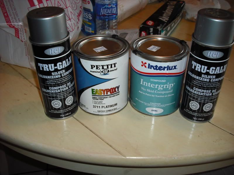

I went ahead and just said screw it and picked up some of this paint and nonskid additive. I was going to go with Interlux bright side, but they didn't have a nice grey color. The only platinum they carry from interlux is the two part one. And it was a bit pricey for right now. I'll probably still go with Sea-Dek in the long run anyway. This silver color for the non-skid will help with the glare off the gloss white deck. The sides of the boat will be teal, but the lettering would be in silver, as well as parts of the upholstery.
