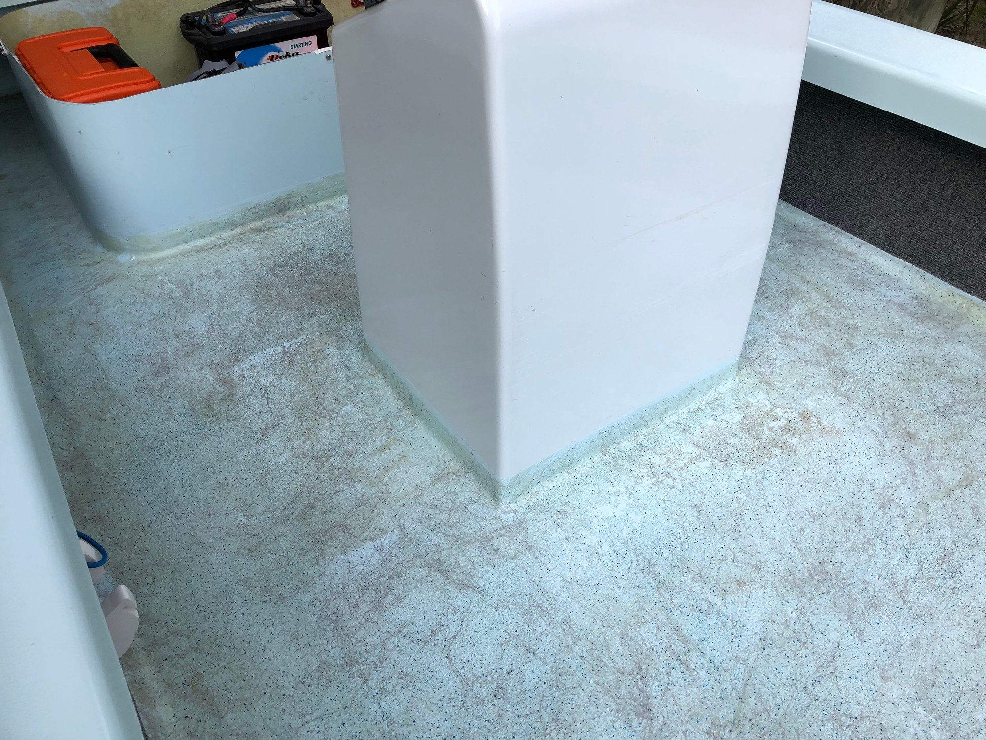

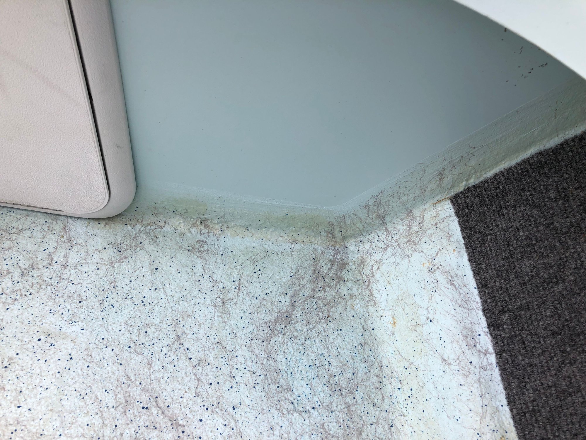

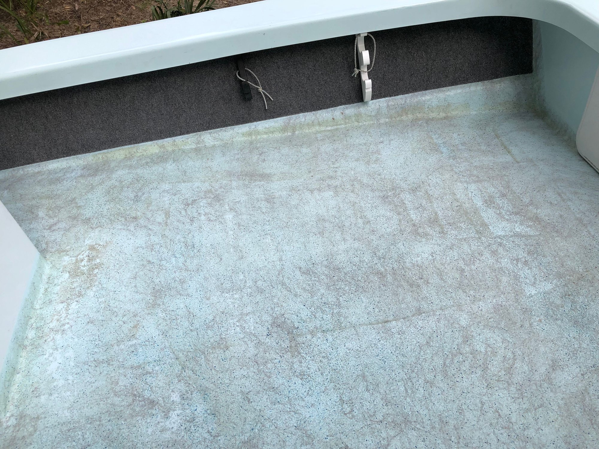

Hey Microskiffer’s. Just picked up a new to me Ankona Native 17. Nice little skiff, but the floor has more of a “commercial” finish. It’s a splattered type gelcoat, I think, that has yellowed and seems to hold dirt. The pictures are after I scrubbed with Starbrite Fiberglass Stain Remover, which on my other boat usually removes everything. The other thing that bothers me is the nonskid was rolled up about 3” onto the front bulkhead, console and stern storage tub and the console is white but the nonskid is blue.
My desire is go with an all white rolled and brushed product inside the cockpit; floor, console, bulkhead and stern tub then cover the floor with Seadek for the skiff pup. So 98% of the floor in the wear areas will be covered by the Seadek, basically only an inch or two around the perimeter and any seam between pieces. I’m also ok with the uncovered portions of the floor retaining the “splattered” look with the new white product. So the finish counts most on the bulkhead, console and stern tub.
At this point, I’m thinking about Interlux Perfection, but all insight and suggestions would be most appreciated. Thanks in advance!

Looking like a commercial fishermen finish, not a trailer queen finish...ace hardware $20.00 gallon oil base paint, r rustolium paint, both will do the job....

Unfortunately its factory. Mine is doing the same thing with the yellow. It just down right looks shitty! Love the boat but this is definitely my biggest complaint. It's also coming off around the center console where the went up the side a few inches.

That yellowing is probably caused from too much styrene in the resin if that is a gelcoat finish. It could also be caused from over thinning with acetone but I don’t think Mel would knowingly allow that to happen.
I would imagine it's one of these because it started happening when it was still new. It definitely not dirt or anything like that causing it.

I had an suv 14 years ago and while it was back at Ankona for some other work they went ahead and just rolled fresh gel over what was there. That's probably the easiest route to go, it looked good after the new gel. If you painted that a solid color I would think it would look pretty bad as it's not even close to a smooth surface under there.

Look into one of the good 2part urethane bedliners. The texture is dependent on spray distance and air pressure. But if you are considering just rolling gelcoat or seadeck this will sorta give you best of both. It will be comfortable, durable, cool to touch, soft on reels if you take it up the gunnels, it is pretty flexable, and easy diy! I like the sem brand, dominator brand, raptor liner, and my favorite at the moment is linerxtreeme. Liner xtreeme uses a rubber crumb for non skid texture but I’d leave that out on a boat!

Thanks all! At this point, I'm leaving off the Seadek on the cockpit floor. Many have said my 80lbs fishing buddy's toenails will tear it all kinds of up. Since I don't want to spray and don't really care to sand, buff and polish gelcoat, I'm still leaning towards the 2 part Perfection
Your still gonna have to sand or anything you put down “Will” peel and/or crack up and look worse than it does now. It’s all about the prep! Another thing ya’ll can try is some on and off. This is an acid but worth a shot. Just don’t get it on anything you don’t want etched. It might being back the white!

Thanks, I was referencing sanding and finishing a new rolled on gelcoat if I went that route. I plan to sand, de-wax, prime, sand, for whatever the new product is

Just wanted to update...went with 2 part primer and Perfection, with added Intergrip on the floor...1000% better!
