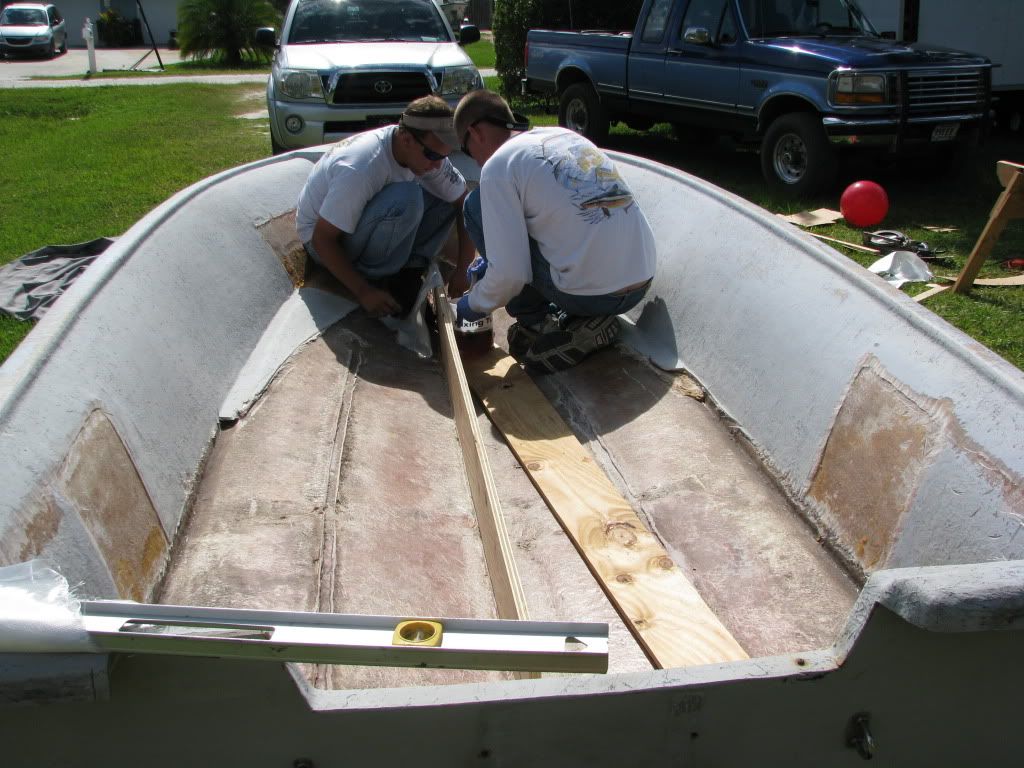

I have ultimately decided on composite due to the fact marine plywood at my mill is 95 dollars a sheet...
Will 1.25" stringers be appropriate for my Hull?

1.25 stringer is massive for a skiff.
Double the cost for composit
Be more specific on model of boat and planned materials and you will get more useful information.
1 1/4" stringers are kinda big - but,i'm a big fan of "overkill"...
composites are allways the better choice - seeing what i see,on a daily basis,why ANYONE would use wood is a facination of mine.the cost for composites are well worth it !
3/4" penske/coosa board is more than sufficient...
cut the board to the angle of the hull,laminate the stringers to the hull using either a good epoxy,or a product such as "cor grip" - coresyn products - the cor grip is designed for bonding composites,it works very well...tab the stringers to the hull,let it kick and then drill the drainage holes,as required - coosa/penske board will absorb nothing,simply wet the holes out,with resin,after drilling...
let me put it in prespective:
most production 25' models have either 2 1/2" pieces of plywood laminated together,or 2 3/4" pieces...

It's a old ashcraft hull. Boggy creeks osborns etc. 14 v
( Osborne hull is being built in the bragging section)
Figured id go composite because it's literally 20 dollars more than my local marine ply...
Far more interested in longevity rather than weight savings.
Plan to fish the boat in the Lower Chesapeake/SC area as well as some freshwater fishing.
Want to do a complete build, Am relatively clueless as the appropriate materials to use.

With that said I'm looking into H60 divinycell for Floor/decks
with 1.25 Airex for transom/stringers.
Going for this look minus console (25-30HP tiller)

Your already on your way.
Just look at the picture and build it the way you want it.
Use the 1 1/4 for the transom but it really is overkill for stringers.
Breeze through the other builds and you will learn all you need to know. When you get stuck ask questions.
Done that what type of fiberglass / resin?
if you're working with composites:
vinylester resin will do the job...
bonding the stringers to the hull,bulkheads the hull -again,if you're using a composite,you can use "cor grip" ...
