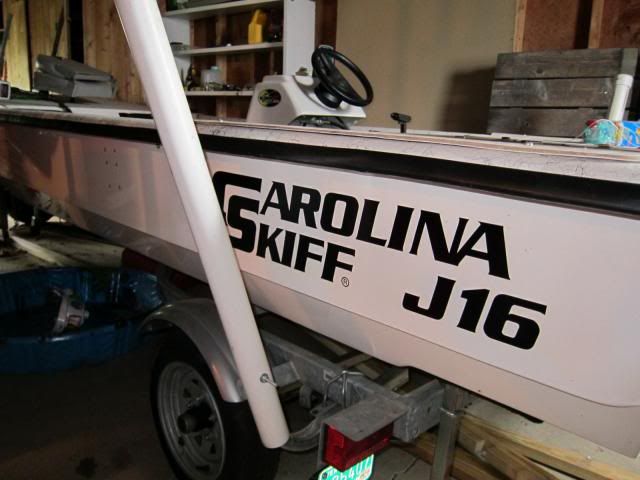

CS has a universal console that 23 inch tall , i believe the picture iam posting is it .  They  also have center consoles , which the small is  30 inch tall ( small one has no seat type area in front of it )and the medium is 34 inch tall ( has a seat type ledge built with console )   . You can use how tall they would be when looking at other pics of  j16's to see if thats how tall you want to go .
  If ,  i was doing it as side console 23 to 25 inch would be in the range i'd  look to do

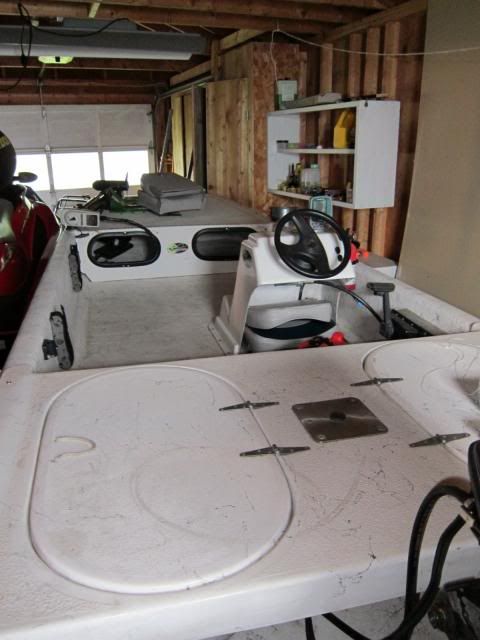

This is mine with the small center console , you might be able to judge of it how tall it would be as a side console
