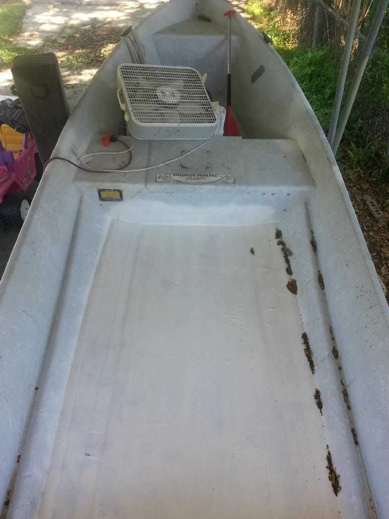

I have a 16' skiff that has a 25hp tiller on it.  I just rebuilt the floor and would now like to make a console for it.  I want something to hold on to to make it easier to stand and steer.  The console would also function as a place to mount my GPS and dry storage for future electrical upgrades.
Here is the boat as it stands now.

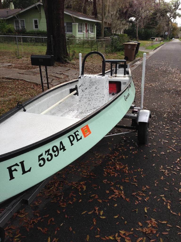

Here is what I have in mind.
i was considering building it out of plywood and then covering it in CSM, but am now thinking of making sometype of mold instead.  Does anyone have any input?

Or buy an ankona and take the console out of it for your gheenoe like he did lol. Seriously though you may be able to buy one direct from ankona if that's exactly what you want?

gheenoechris im glad you like my consoled in my nmz they are correct i bought a used ankona console of the site and then just glassed it to my floor and painted to match its awesome and adds some storage for me ;D
