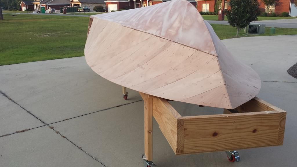

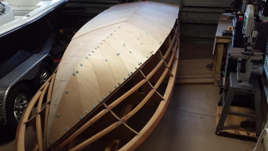

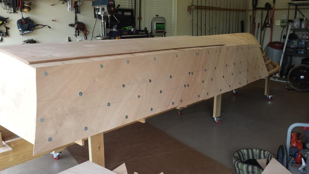

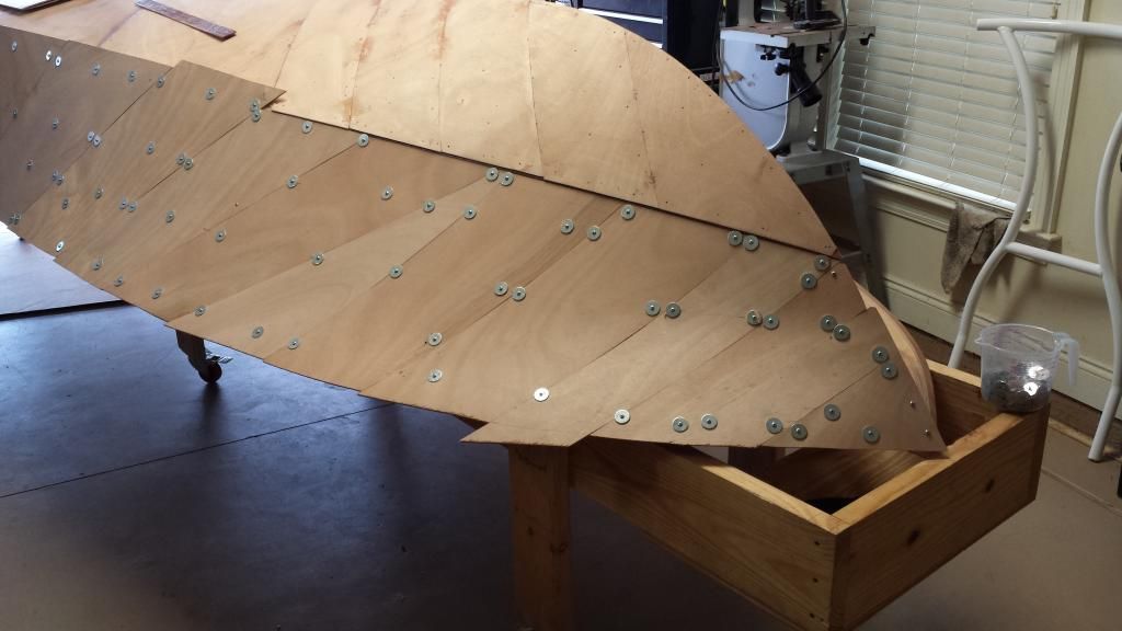

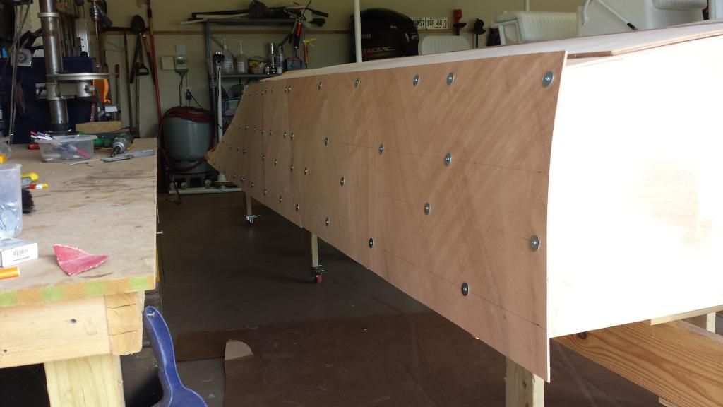

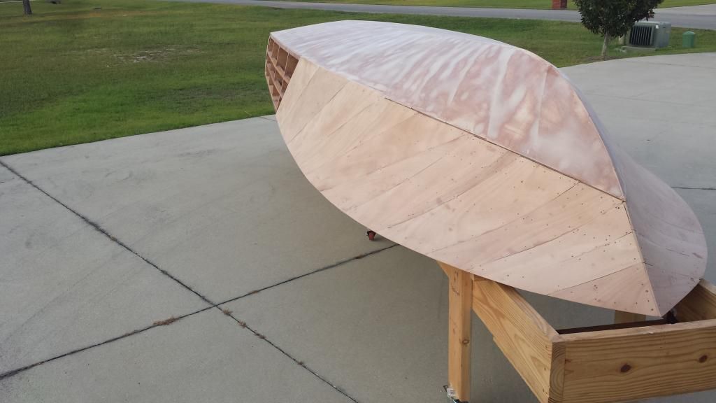

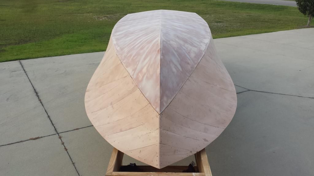

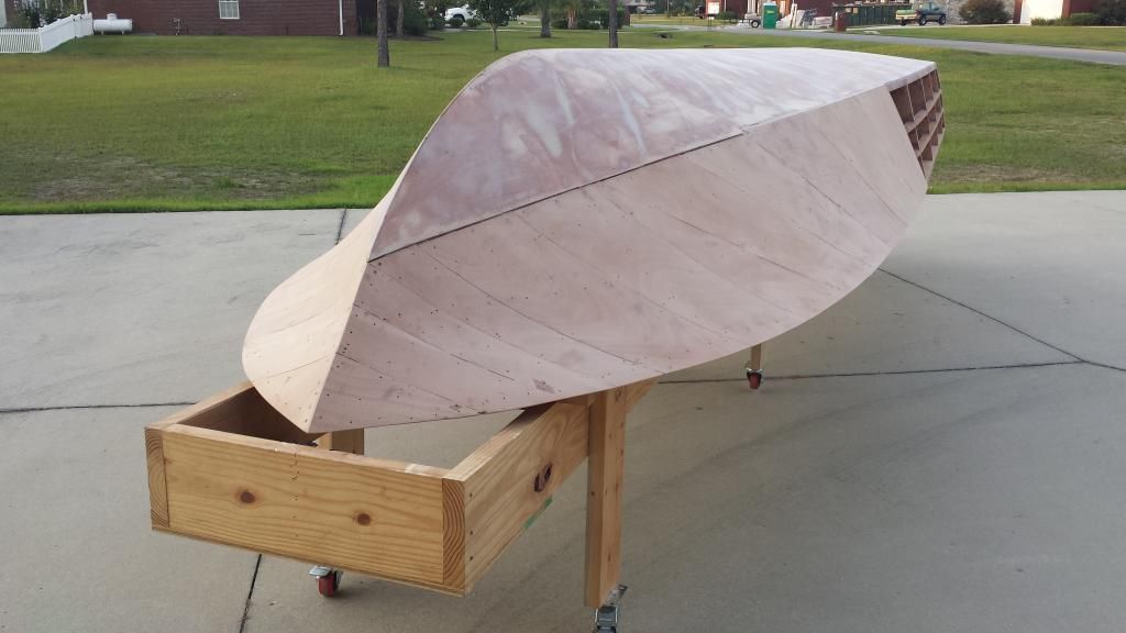

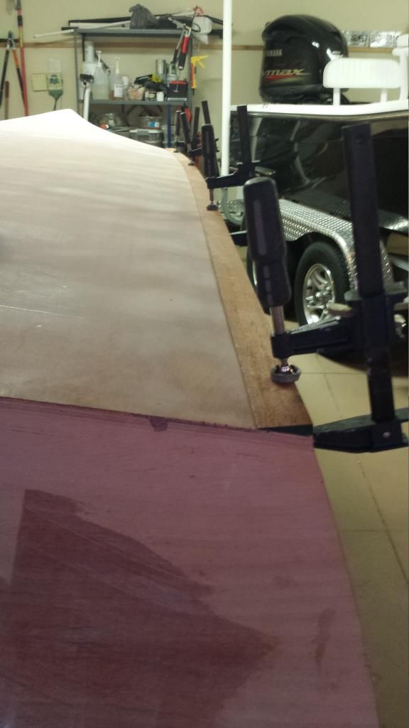

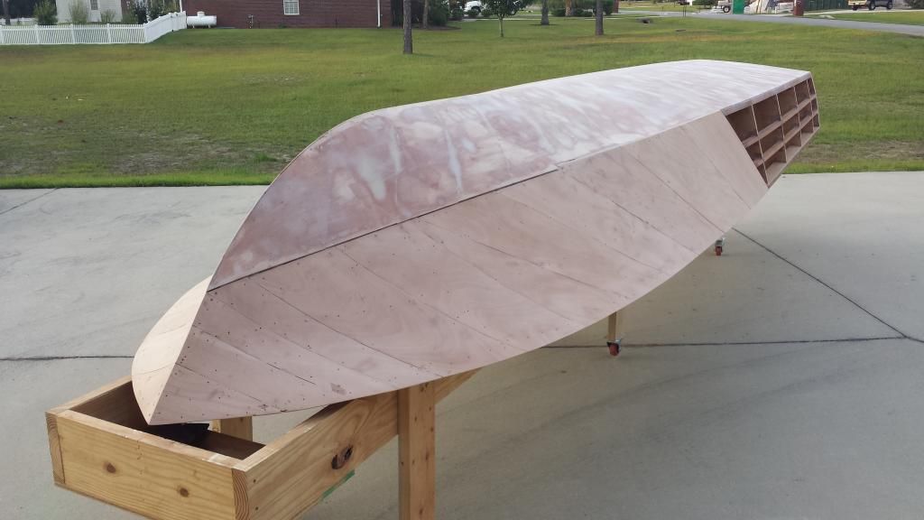

Since my last update, I faired the bottom with a cabosil and West 810 mixture that learned from a big boat builder. It sands very close to the surrounding wood. I did this to make it easier to fair since I will be adding my reverse chines before I plank the sides. With the reverse chines in place, it would have been hard to long board. The bottom is ready for glass at this point.

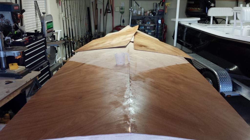

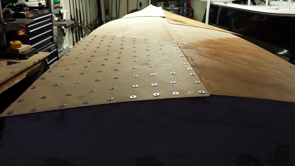

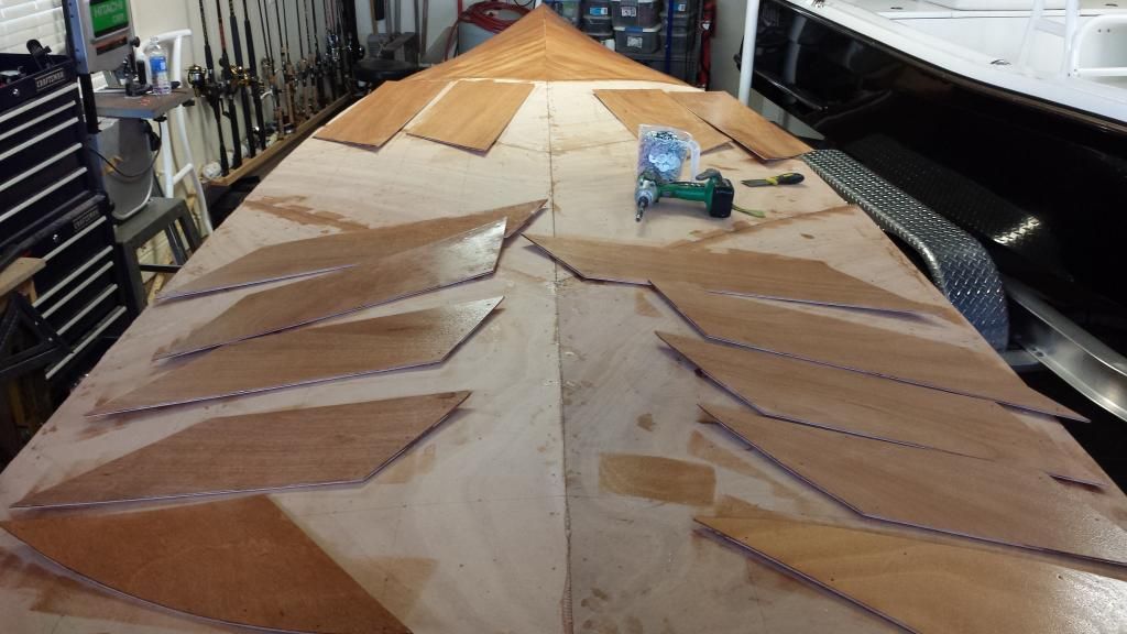

After that I glued up the planks up front, back to where the reverse chines start.

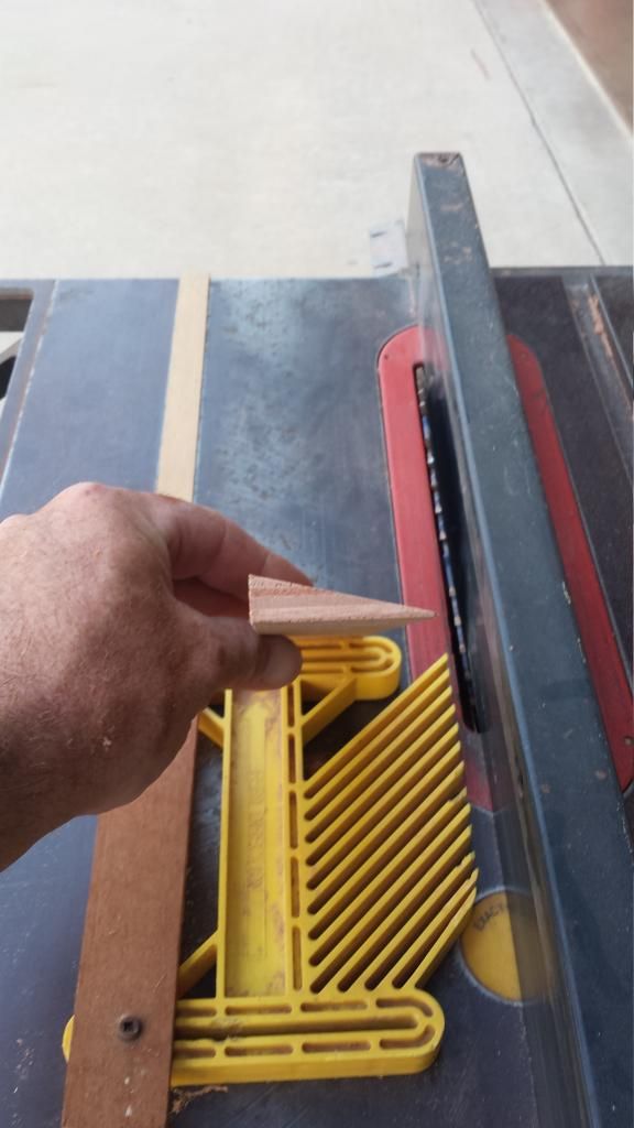

Setting up the table saw to cut my reverse chines
Checking fit to ensure 5 degrees
Testing fitting
Next, I will get the reverse chines glued up and then continue gluing up the rest of the planking.

That hull has such beautiful lines.  I'd love to see one actually on the water.  You have a very good chance of beating Oyster at the rate he is going.  Keep up the good work.
