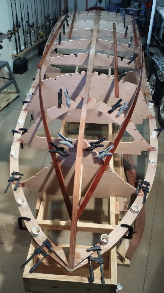

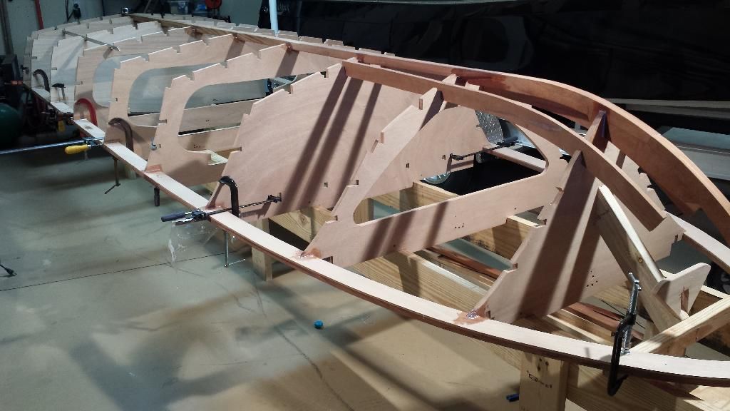

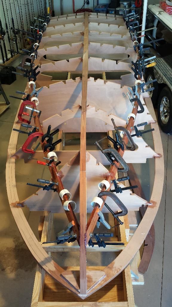

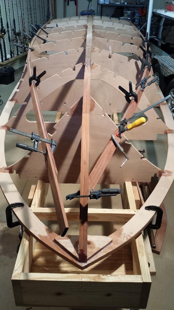

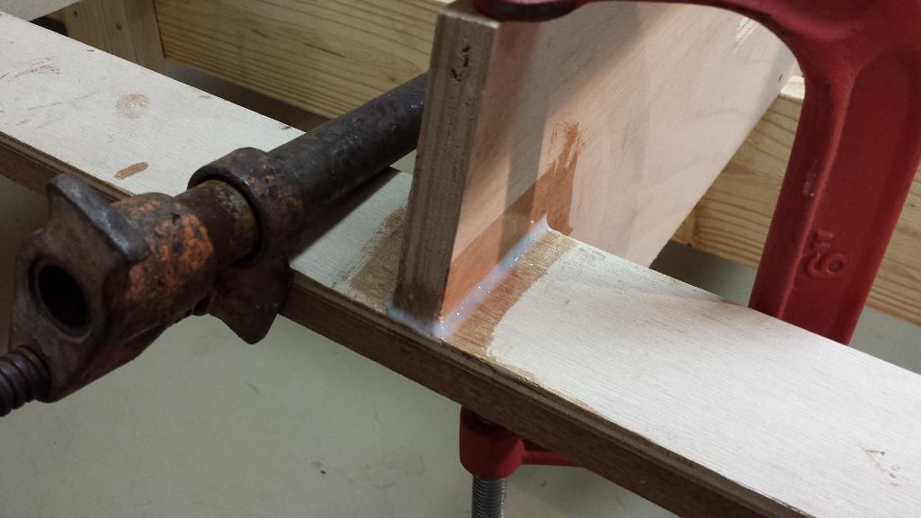

This morning before work I got the other side of the harpin routed, cleaned up and clamped in place. Tonight, I will double check all my measurements and alignment with plans to do the glueup of the harpins on Saturday.

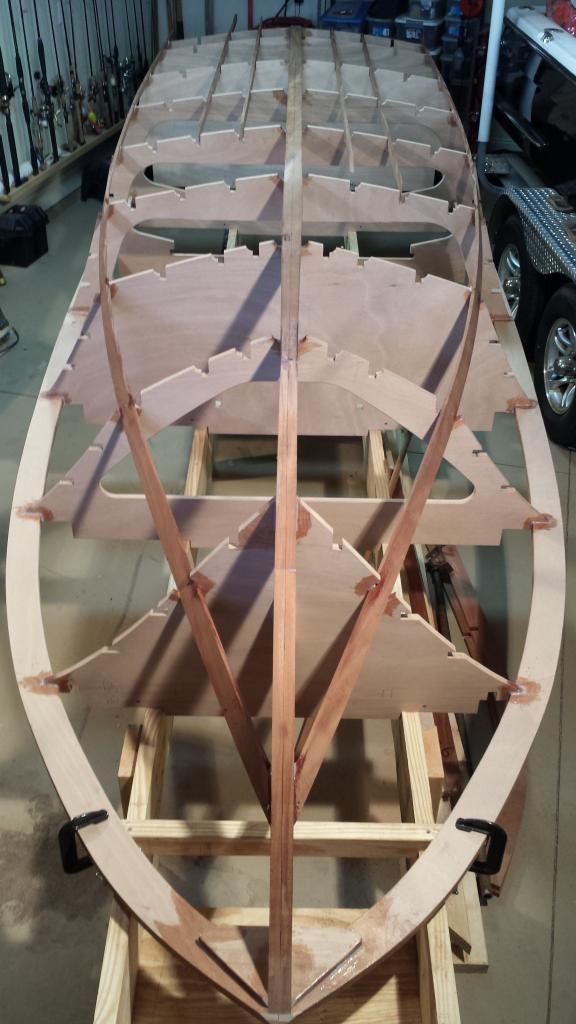

After that is cured, do you all think it will be OK to put the strongback on wheels? Or should I wait until I have the chine logs glued up?
· Registered
1,659 Posts
What did oyster do?
General boat building rule of thumb is, if you have to ask...
You should probably finish
I think he went to wheels after he had his frames set....
NOPE!
I put the wheels on when I built the strong back, well before my first frame went on. I blocked up the bottom of the strongback so that the wheels were suspended in order to level the system. After those frames are on and depending on your strong back, it'll be HARD to put the wheels on afterward. It's much easier to simply unscrew the blocks and kick them out of the way than to try to lift the while system AND SCREW some wheel in IMHO.
