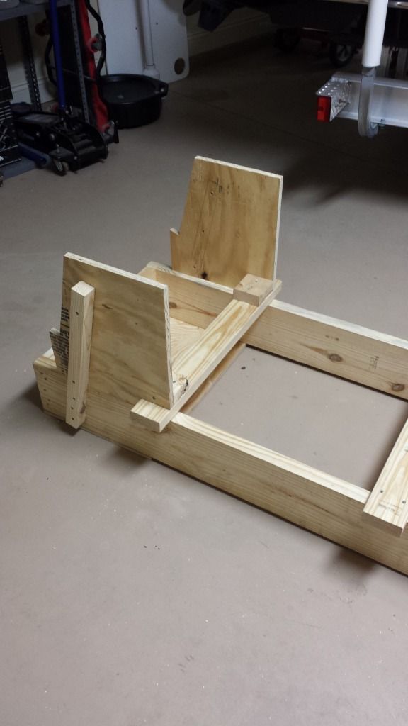

I put 6 casters on it this weekend and was kicking around ideas for shimming it to get everything level. I like your idea as shimming the wheels wasn't working too well. Having wheels is going to be great as my work area is small. I can however move the bayboat and car out of the garage if I need the room for the day. I am planning to do the heavy sanding outside if possible.

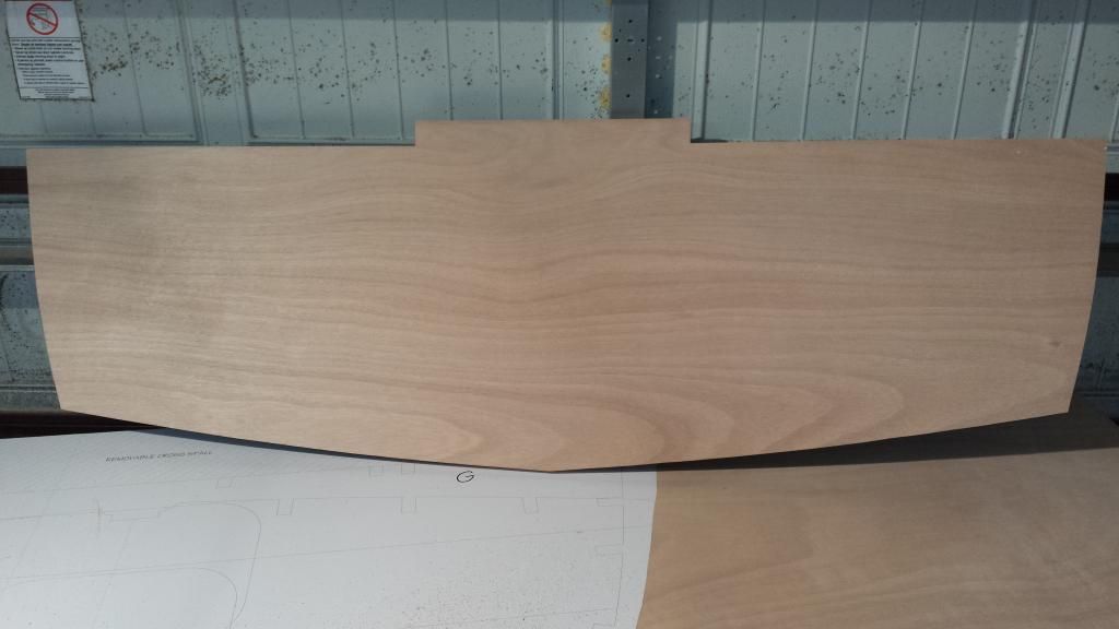

That is some pretty damn plywood. Looking forward to your build.
Agreed, I was impressed.

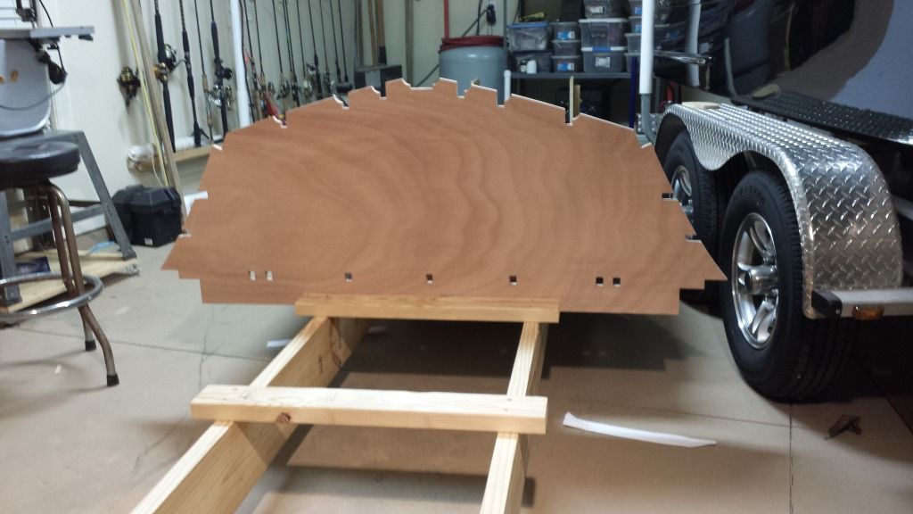

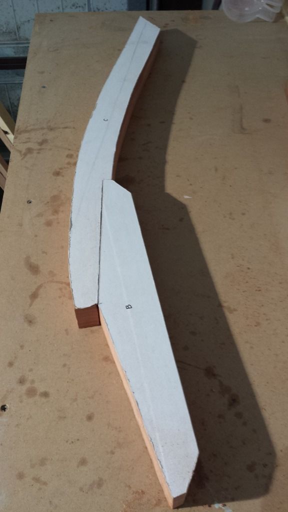

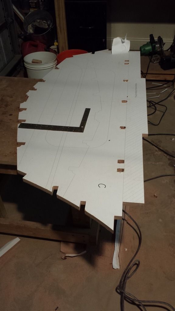

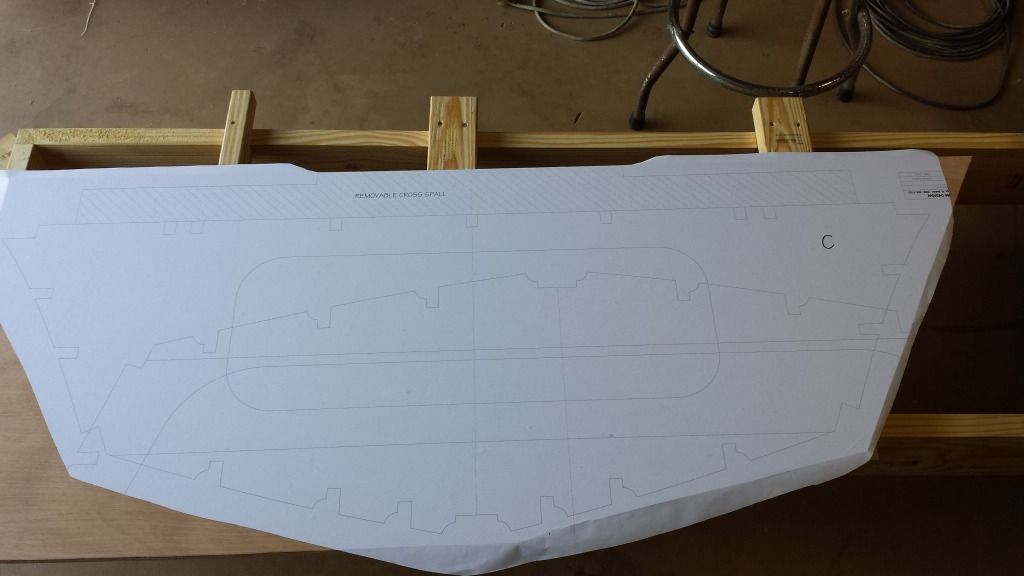

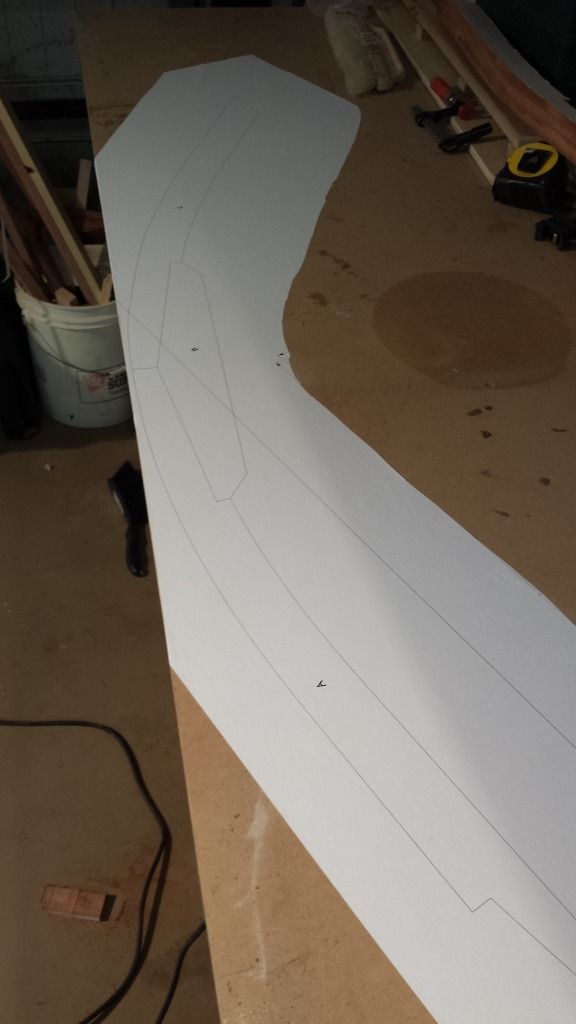

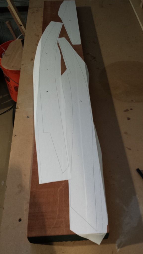

I took one sheet out and rough cut it to size for two of the frames. Here is full size template for frame C glued to the wood with 3M 77 spray on the paper only. This allowed my to re-position the template as well as providing a bond that did not leave residue on the wood, but held the template very well while cutting.
All cut

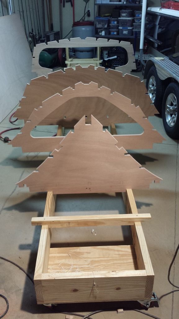

I had to throw it up on the strongback...

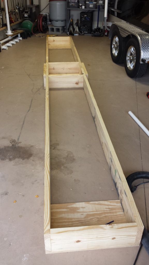

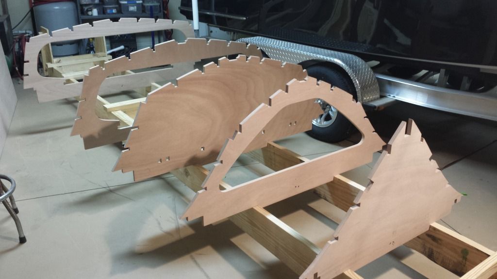

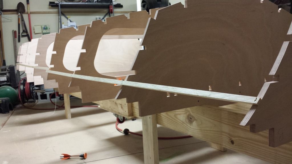

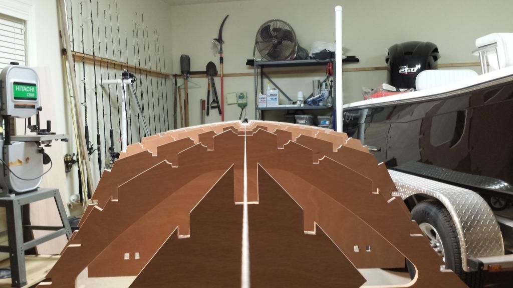

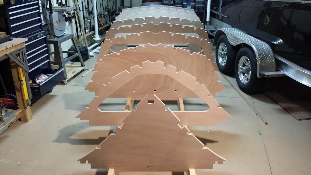

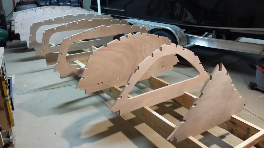

I raised up my strongback and leveled it using some legs in preparation for installing my frames. I added string line independent of the frames to act as my center line. It hovers about 1/8" above the frames. Next I installed each frame making sure it was centered on the string line and square to the frame. I checked the frame's fairness with some batten and eyeballed it for a good 30 minutes. All looks very good.
Now I calculating how much mahogany I need to get started on the stem, keel, and harpin.

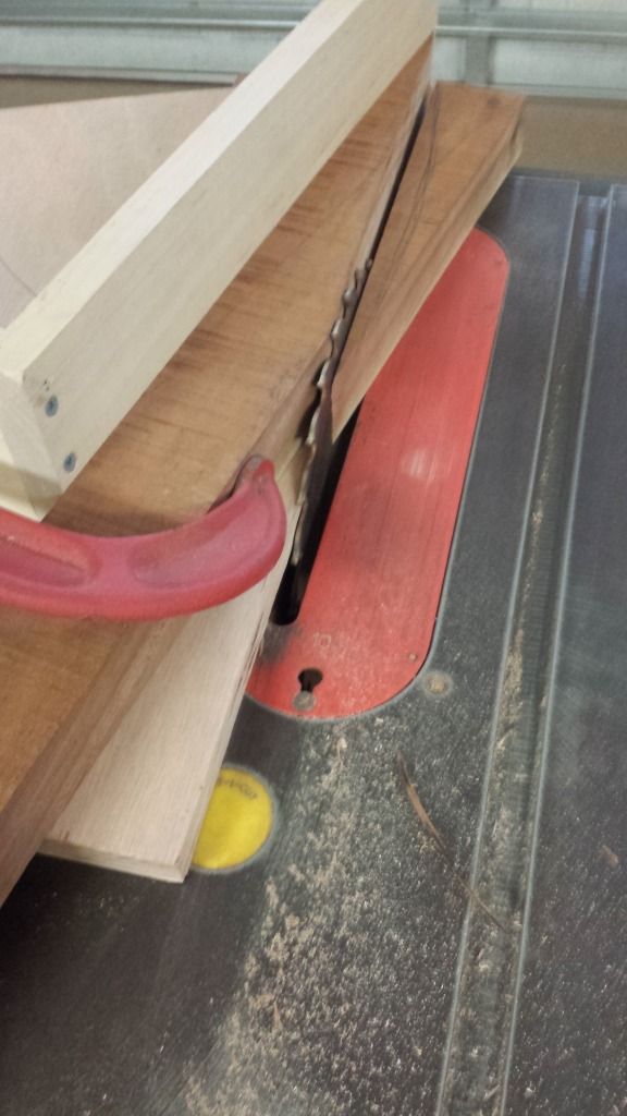

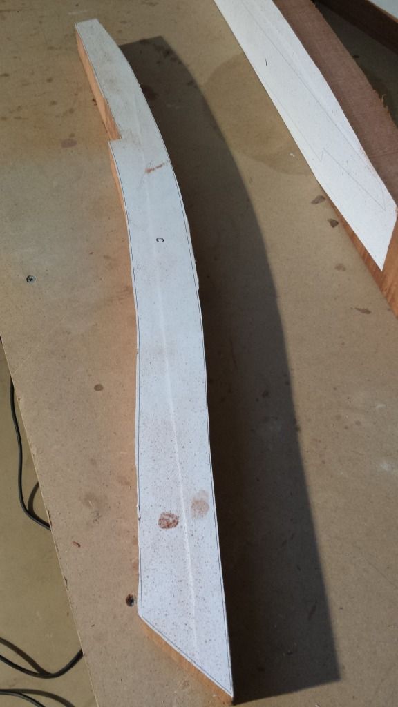

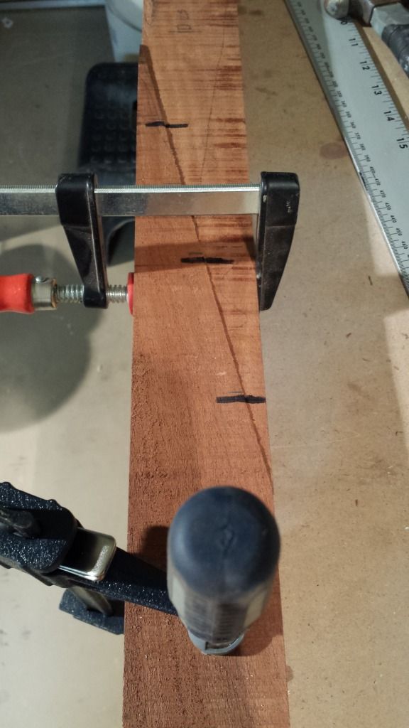

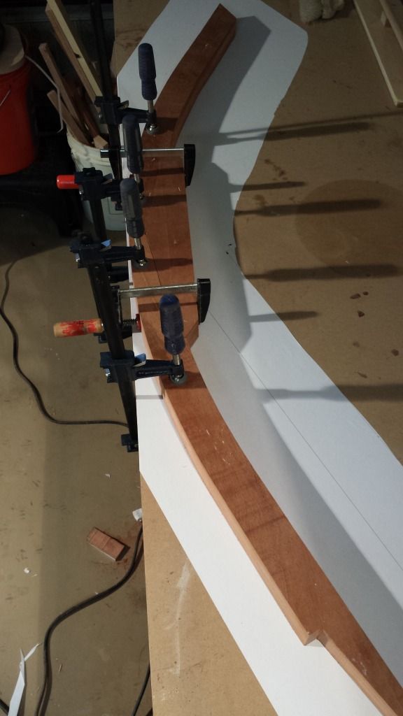

The keel tapers down an inch to meet the stem. I screwed a piece of wood to the keel matching the taper angle and ran it through the table saw. Flip and repeat for the other side. You can see the taper at the far end in the last image.

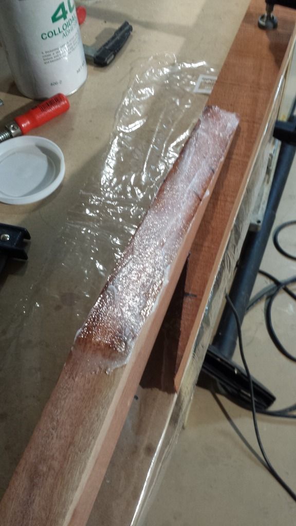

I built an adjustable scarf jig for the table saw and cut the scarfs for the keel.
Dry fitting

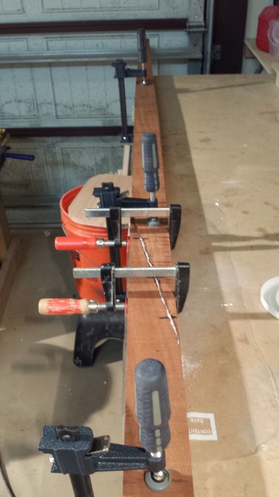

Buttered up
Clamped
