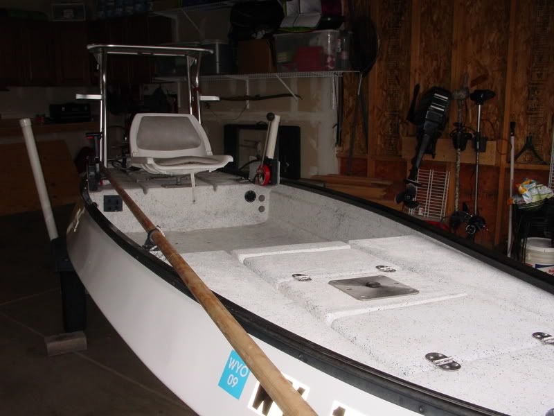

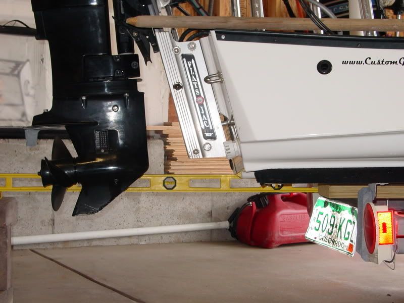

Ok so here is the deal. I have a 03 Kevlar Classic with a front deck, stick steering, battery in front. I have a hydraulic jackplate with a 25hp Mercury with a stock prop. My issue is that I can get about an inch of travel upwards before I get cavitation. Since I live in Colorado I do not need to worry about having to run shallow, but I would like the boat to perform how it was designed to with a jackplate. I would like to improve top end and also am not concerned with holeshot. What would you do?
Fully Raised
Fully Lowered
Fully Raised

Thanks again man. I get about an inch of travel up and then it starts to cavitate, so Im not even sure if it will totally blow out if I travel higher. Do you think the prop will solve the problem if I were to raise the jack plate all the way up or what?
The quicksiler propeller 3 blade S.S prop will improve your speed but won't run it when u jacked all the way up.
U can add cupping on the S.S propeller to bite the water a lot better and might able to run all the way up. Max u can go about 4.5 - 5 inches above the transom.
Or u might want a 4 blade S.S propeller but might slighty lose 1 to 2 mph and still able to jacked all the way up.
U want improve speed then go for quicksilver or powertech 3 blade S.S propeller 13 inch pitch with standard cup.
