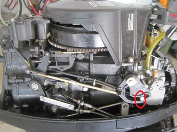

I have circled the throttle lever in the pic below...my question is this, Is the plastic bushing that rides in the slot SUPPOSED to be flat on one side? looks like wear.but I'm not sure. I'm having issues getting the motor to start without forcing the throttle open. I also cant get it to hold a proper idle. Wide open runs fine, Seems like a low end range issue, it just settles down and then starves out.

No idea if it's supposed to have a flat spot.  :-/
But as long as the fit is snug in the slot, I'd leave it alone.

Carb is freshly cleaned and rebuilt, no change in the problem. As for "snug" :-/ ... there is a good amount of slop in the linkage,but has been like that since I got the motor,and it ran great for the first year, this issue has come on slowly and I was keeping it at bay by adjusting the linkage and tweeking the idle...I'm over it and want to get to the root of the problem. I'll check the plugs again, they are new and have never seen much run time other than in the driveway while running in the water tank, no real "use".

Your motor doesn't have a carb cover from the factory. If your talking about the roller cam on the lnkage no it should not have a flat spot, but that wouldn't casue your problem.
